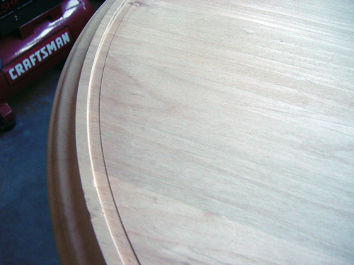

Members CitizenKate Posted January 13, 2008 Members Report Posted January 13, 2008 Maybe some of you can help me with this... I've got an unfinished elder wood occasional table that I'm finishing with an inlaid leather top. I've routed out a recessed area 1/8" deep over most of the top in which to place a piece of tooled/finished leather. When finished, there will be a little bit of wood showing around the edge of the top. The diameter of the top is 24". I want the inlay to fit perfectly into the recessed area of the top, with no edges showing and no gaps anywhere. I have already made one attempt to cut a piece of leather to fit into this recessed area, but anyone who has done any work at all with tooled veg-tan (especially a piece this size), it tends to shrink and get out of shape. So as you might guess, despite cutting it slightly larger than the actual size, and my best efforts to prevent shrinkage, it shrunk anyway, and was no longer the perfect circle that it was when I first cut it. It's now sitting in my boo-boo bin. This is my first attempt to do an inlay, so before I sink too much more time or money into this, I wonder if any of you out in leather land have any tips or stories from the trenches that might help me make the best of my second attempt? Kate Quote
