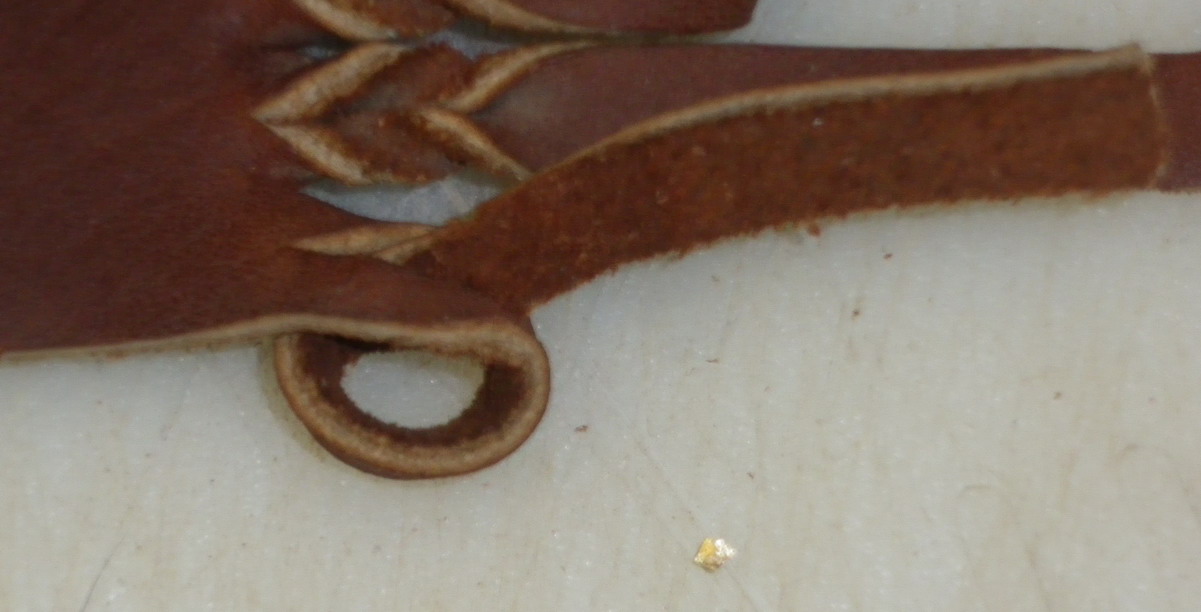

Hi I will try and explain here how I do it . On a pair of chaps/chinks where you are using just one color your not really doing a true bleed knot, you are just taking and making a slit in the fringe close to the main body of the chap/chinks.
Next you will take the end of the fringe and go to the flesh side and put the end though the slit from back to front.
It is more so just turning the fringe.
Hope this helps.
