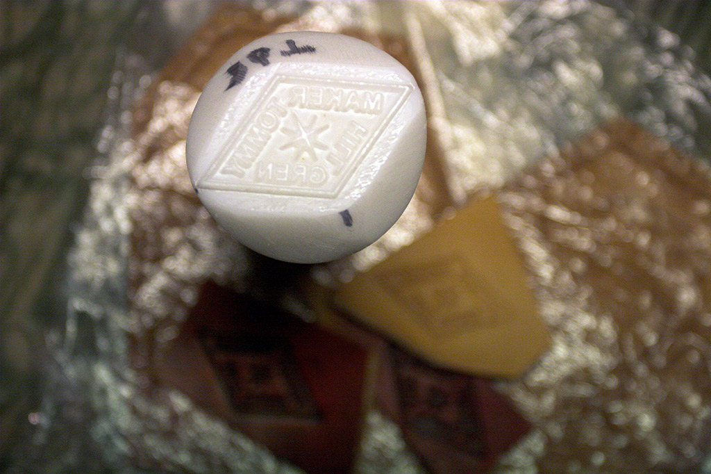

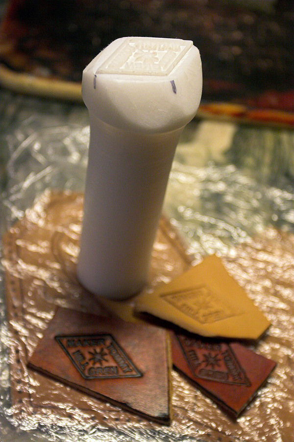

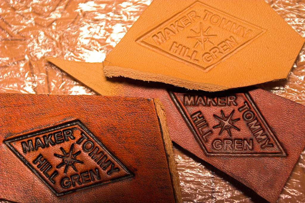

TomSwede Posted May 13, 2008 Report Posted May 13, 2008 Couldn't find the thread for showing off makers stamps but I think it would belong in this section?? So, today I got my makers stamp from Indypbear John AKA indy at Front-line productions. It's made in the new (to me) exciting material Delrin (resembles nylon but alot heavier and harder). I love to try new stuff and the sturdy feel of this one is suiting me well. Small handles for stamps that need force is not for me. It looks supernice, everything is level and straight like it should. I've been using Craftools big letters a bit and can't say that steel (or whatever the're made of) doesn't feel any better. I always have problems with getting it level and therefor getting less impression in bottom right corner. This has to do with my body position when stamping. Think I'm gonna switch to a lighter hammer (use a big sandhammer now) 'cus I get to much digging in in the opposite corner. It's all about control I think. I also got a nice little calendar in the package and I like little treaties very much, also where a sample on leather from the stamp and that one is definetly done by someone with control so big thanks to you John and Front-line Productions! Tom Quote Confucius - Better a diamond with a flaw than a pebble without. --------------------------------------------- www.1eye1.se blogg.1eye1.se
ArtS Posted May 13, 2008 Report Posted May 13, 2008 I just got mine from Grey Ghost (Jeff Mosby) on Saturday. It's great. At the last class I attended someone had a great idea for a makers stamp hammer. They bought a dead blow hammer. I tried it and liked it. No bounce so you don't accidentally get a double stamp. ArtS Quote Art Schwab "You cannot teach a man anything. You can only help him discover it within himself." – Galileo Galilei
TomSwede Posted May 13, 2008 Author Report Posted May 13, 2008 That's a very good and smart design Art! Did you come up with it yourself? The sandhammer I use is a deadblow hammer so it digs in to hard at first blow wich makes it difficult to level out the impression afterwards. Still with that sandhammer it do bounce if one doesnt press firmly down with it, get that with both Cfartools letters and the delrin stamp but the craftool is more of a struggle because of it's handle that feels too narrow in my hands. Looking at how smooth John's impression with this stamp is makes me realize I gotta practice more. Gotta try it sharp today with the Freak coffin notepad I'm stressworking with to get done tonight. Tom Quote Confucius - Better a diamond with a flaw than a pebble without. --------------------------------------------- www.1eye1.se blogg.1eye1.se

TomSwede Posted May 14, 2008 Author Report Posted May 14, 2008 A jig sounds nice and some sort of press would be great to for those late night leather sssions. I got nieghbours to think of. Tried the stamp on a "sharp" work yesterday and starting to look better now. Tom Quote Confucius - Better a diamond with a flaw than a pebble without. --------------------------------------------- www.1eye1.se blogg.1eye1.se
