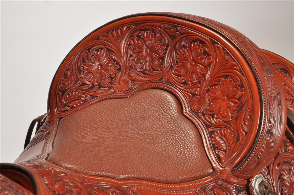

Members kseidel Posted February 12, 2011 Members Report Posted February 12, 2011 I have had these pics on a cd for months and finally got some into the computer. This saddle won first place in the tooled saddle category at the 2010 "World Leather Debut" in Sheridan Wy. It was not published in the Leather Crafters And Saddlers Journal, so I thought I would post some pics on here. It is a 16" modified association 14" wide, 4"high X 13"wide cantle with 1 3/4" cheyenne roll. #4 Post dally horn with 3 1/4" cap. Fully tooled with a wyoming wild rose pattern with smooth leather under riders legs. The saddle features an inlaid padded seat, is fully lined and machine stitched @ 8 stitches per inch. Color is two tone chestnut. Note the seat is inset into the swell for a flush fit. Keith Gertsch made the tree, and Rob Schaelein made the sterling silver conchos. Thanks for looking. Keith Seidel Quote

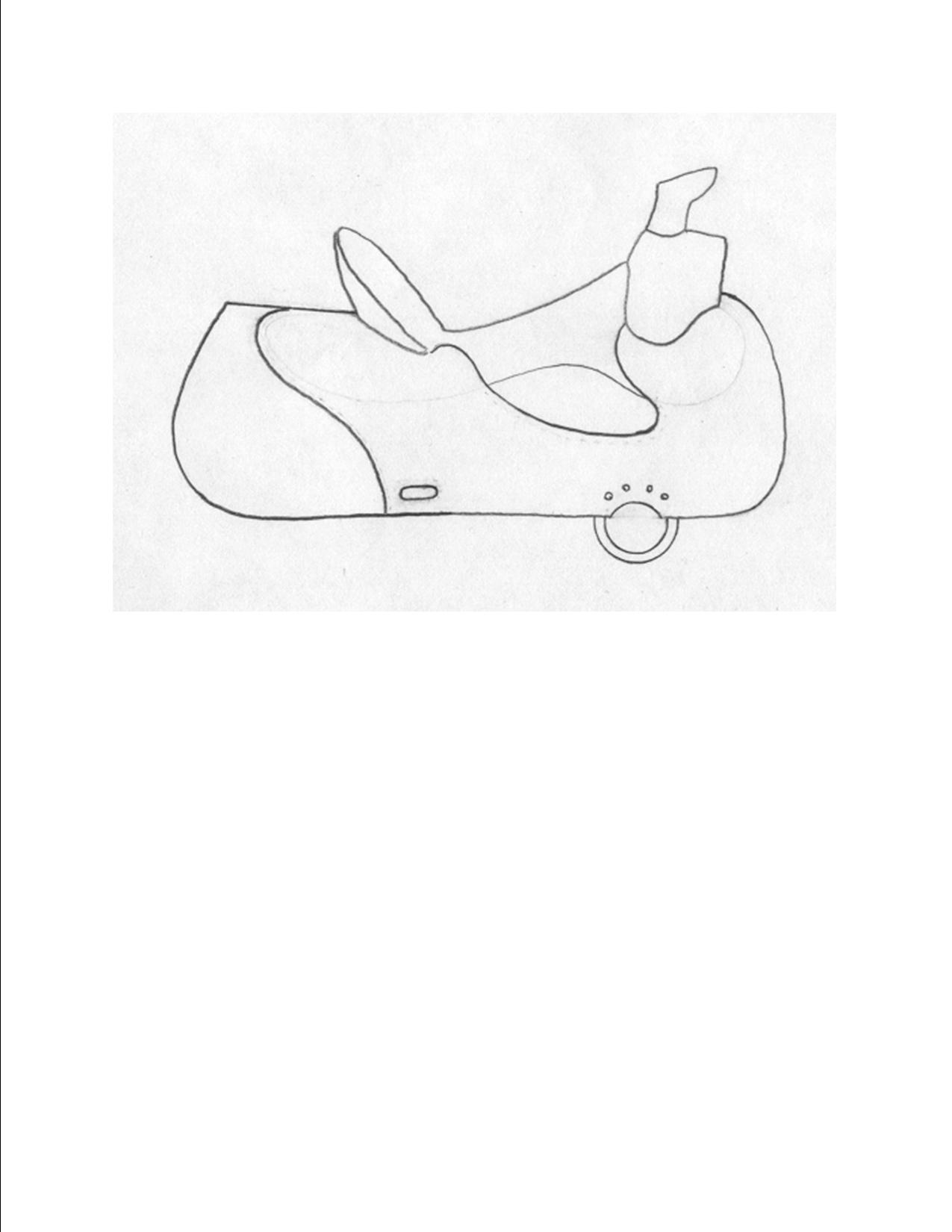

Members GrampaJoel Posted February 12, 2011 Members Report Posted February 12, 2011 Mr. Seidel, To comment on the beauty of this saddle would be superfluous. As a want to be saddle builder, I don't have the words anyway. Just looking at all the work, and skill that went into making a saddle such as this is almost more than I can comprehend. Especially knowing (from first hand experience), how one slip of the tool can destroy a piece of work. May I ask of you Mr. Seidel,( or anyone that knows) is this saddle an in-skirt rigging design? If so, what is the line of stitching going up at the back billet for? Thanks . Joel Quote

Members kseidel Posted February 12, 2011 Author Members Report Posted February 12, 2011 Thank you all for the compliments. I'm glad you like it. I know that I sure appreciate seeing work that others post, I just don't take the time to post many pics. May I ask of you Mr. Seidel,( or anyone that knows) is this saddle an in-skirt rigging design? If so, what is the line of stitching going up at the back billet for? That is an in-skirt rigging and the stitchline you see behind the rear billet is the back edge of the rigging plate. The rigging plate is a single piece overlay that covers the front of the skirt and extends to behind the slot which makes up the rear rigging. It extends up to the tree and creates a housing for the back bar. I feel the rear rigging is better supported by ending the rigging in this way and having the stitching to add rigidity. You can see the shape as demonstrated by the attach diagram. Quote
