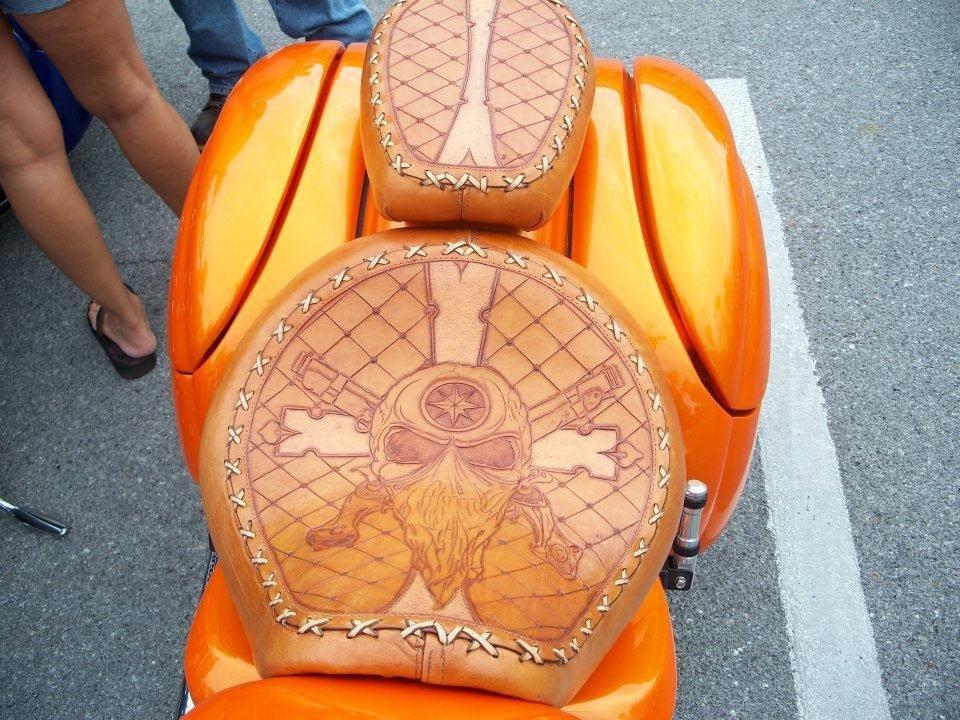

Hey Jimbob,
your wetmolding is spot on and i like the different lacing. it's cool. Your designs are pretty neat for the good ol' skulls and flames. One critique I have is that I think you can carve deeper into the leather. Then when you bevel the difference between the raised leather and the beveled parts will be more prominent and more "3D". Other than that, great job!
Chris

Hello Chris
Good observation and thanks for the praise...
Yes the carving could be deeper....but I am using 3-4 oz tooling leather for the top and about 2-3 for the skirts.....the reason I am limiting myself to the deph of the actual carving is simple...if you cover an upholstered seat with inlaid gelpad with, say...6-8oz then most if not all the effect of comfort is gone....these seats are mostly NOT bar hopper chairs, they will be ridin hard and I mean 300 miles plus.....so the comfort factor is important.....on the few hard ass leather only seats I do 13-15 oz skirting and carve in as deep as I can.
Guess you have to go the middle way to please everybody....but then again, looks is cool but usability is first in my book....scooters are for riding and not for parking at Daytona bike week...haha...
Thanks for checking out my seats....and if I ever get as good as Dave then I have myself a sixpack of room temperature dark beer...haha

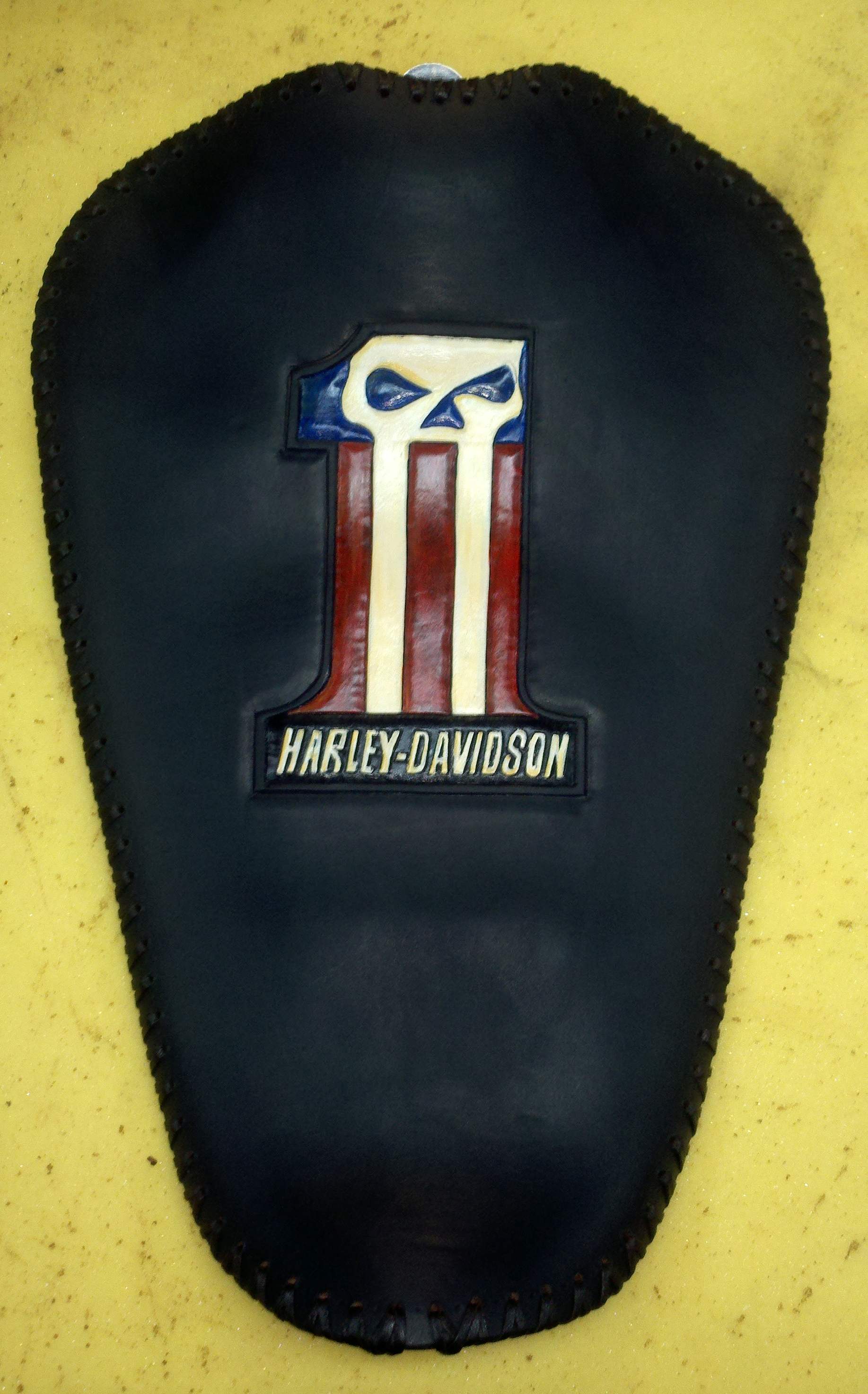

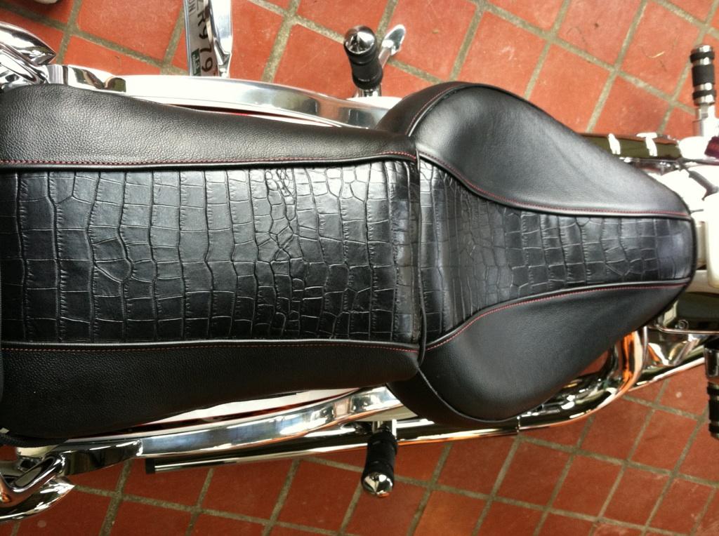

Oh, and gelpads are available in different thickness...I do use mostly 1/2 inch and for big seats 3/4 inch pads....saddle man gel pads are affordable and super quality!
Guess it all depends on the rider and his style he wants...I am always open on what the bike needs and the rider wants....but I try to do it as good as possible to make it tru leather craft....
Some of them seats in these pics are carved, some are half done and some are extensive upholstery with gelpad insert and chome leather only...!!

Loving the carved seats, Jimbob..it's obvious that you've spent a lot of time putting fine detail into them.. I especially like the first one, on the orange Yamaha.. The pic reminds me of a video game I used to play..
The last two pics, I guess show the chrome tanned leather.? I think the rear pad looks a little loose on the foam and could do with some rework.. I can't fault the piping and the stitching, but the front of that piece stands out more than it ought to..IMHO..
Besides that, some pretty nice work.!! (and with finally getting the pictures back up too..lol..)
