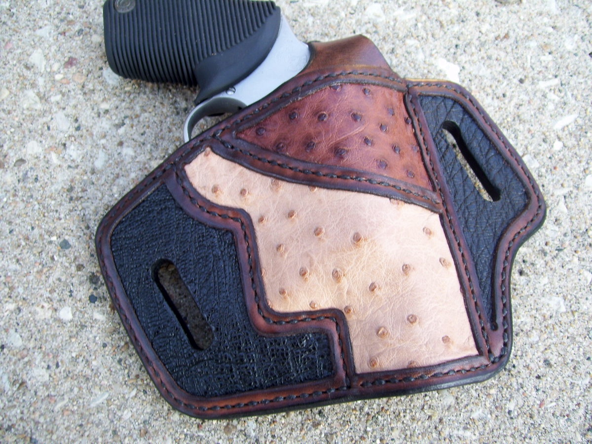

Members Sixer Posted August 9, 2011 Author Members Report Posted August 9, 2011 (edited) On 8/9/2011 at 3:49 PM, JLD said: Hi Eric, When you buy your 2lb pack of ostrich could you let me know how useful the pieces were eg size colour etc. I am in Australia and just want a little more info from someone who has bought a pack before I try. Johanne Johanne, The pieces where great! Actually better than I had expected. I really didn't need much, but there were plenty of nice medium and small usable pieces, in black, brown, and a light tan color. I'd say about 33% of the ostrich skin had quills. I don't have any pics of the bag of pieces itself but here is a pic of the holster I made using the ostrich from SLC. I'd also recommend giving SLC a call before you place your order. If you let them know what your looking for they can usually get you what you need. Hope that helps! Cheers, Edited August 9, 2011 by Sixer Quote
Members particle Posted August 9, 2011 Members Report Posted August 9, 2011 Very nice! If you had to guess, how many holsters like that could you make out of that one bag of pieces? Quote
Members Sixer Posted August 9, 2011 Author Members Report Posted August 9, 2011 On 8/9/2011 at 6:30 PM, particle said: Very nice! If you had to guess, how many holsters like that could you make out of that one bag of pieces? Thanks Particle! IF I had to guess... I'd say you could make at least 8-12 holsters like this one with the 2 lb bag. 2lbs, even in "scrap" is quite a bit of ostrich! Some of the pieces are big enough to cover the entire front of a small to medium semi-auto holster. I'm assuming that these bags probably vary quite a bit, so I'm not sure if I just got a good bag or if this is the standard... I do know that it was well worth the $15 or $16 bucks YMMV Quote
