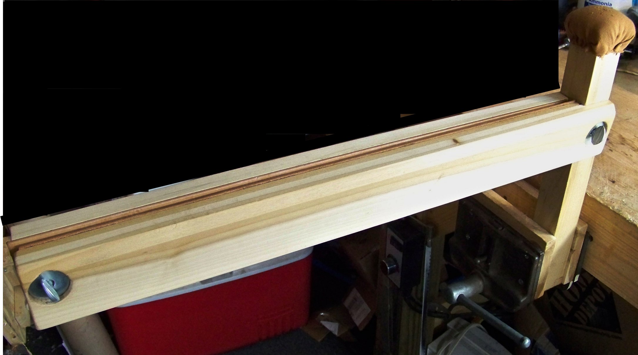

This is a horizontal stitching pony made from dimensional poplar wood available from Lowes and other sources. Scrap pieces are included to show how it works.
Jaws are leather lined and simple clamps are used to hold closed and to the table. Table clamps left off for clarity.

This is the rear of the pony showing how one can add leather shims to keep jaws parallel

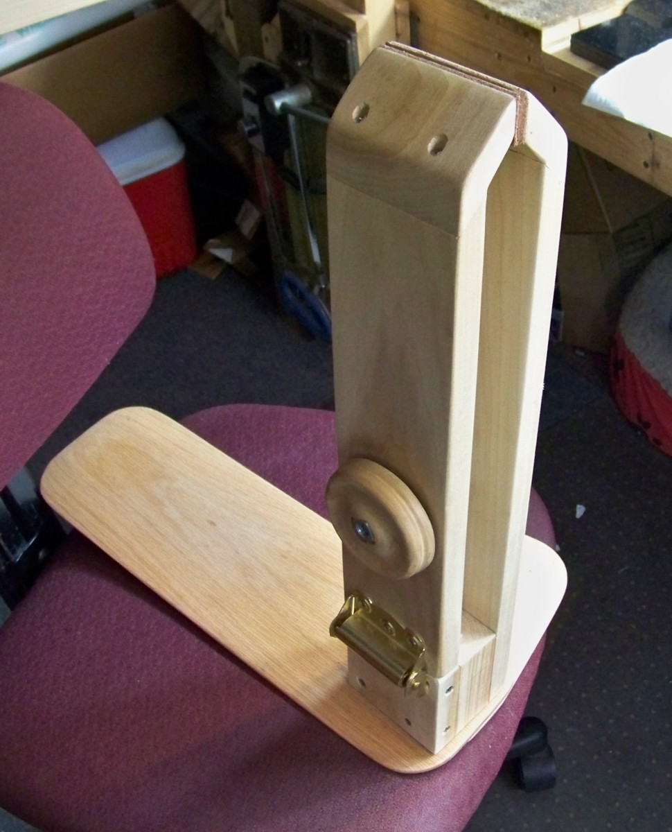

Here are a couple Stitching related handmade tools, I made a couple years ago. The first one is my "Rapid Repeater",,, it uses an awl, to punch the holes for hand stitching. Makes it a lot faster,,, & keeps everything in a lot better alignment. The next thing is my little stitching pony. It's made to sit on,,, so if I want to take my stitching inside,,, I can do that. I also have a stitching clamp I use quite a bit, since I do a lot of Bible Covers & Portfolios,that require more depth.
Thanks for looking,,, these are just the tip on the "iceburg" Ed the"BearMan"
