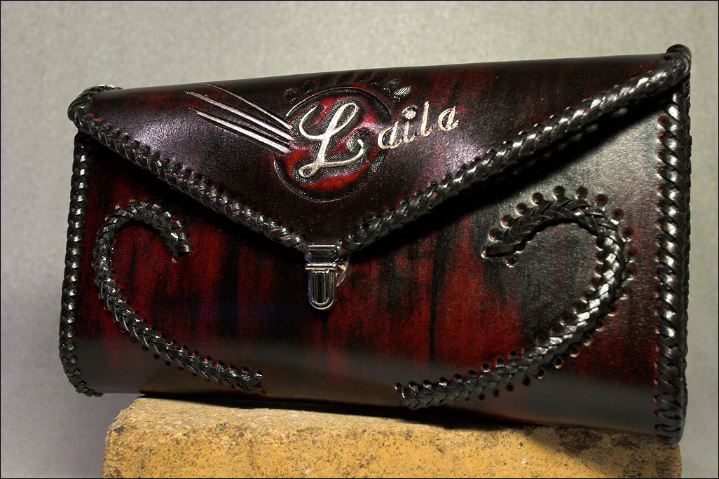

Ladies night, just finished a purse
Liner is glued to a thin layer of cellpadding to give extra protection for cellphone, Mexican basket weave ShirleyZ style braids to hold it together and decorative braid is triple loop. This is the one shown in a thread about getting this black/red effect.

You've got the hang of seating/orienting that maker's stamp without a bounced image. The purse/case looks really good! What's the lining that you used?

Thanks guys!
Yeah that stamp is tough to handle, just gotta be firm with it.
The liner fabric is some sort of satin blackish red colour with black decorations on it. It really was a good find for this project.
BTW, the liner was difficult to glue since it is so thin. Had to remake it one time 'cuz the first one was bleeding through and looked bad.

You must have a strong arm to control that maker's stamp. I've found that when I whack my maker's stamp with a mallet, I get that bounce everyone talks about. If I whack it with a 1 pound rubber mallet, I get a very clear impression with no bounce. Must be the mallet bounces instead of the stamp?

Haven't figuread out what forces is going on when whacking big stamps but here sure are forces and ways to del with it. I saw some people prefferred a metalhammer (!) some rubber some dead blow types.
I use a 42oz deadblow and keep my work to the ground and lay my bodyweight over the stamp and then strike.

I had faith you'd develop a technique. Deadblow is good and a firm grip tight to the project with ONE strike!
Small mallet-small die, Large mallet-large die, mobetta.

very nice purse you did there !! Could you please tell me in which thread there was written something about this black/red effect ?!? I´ve searched, but wasn´t able to find it.

This purse goest to a girl named Laila at my job. She saw the first rodtube and was sold on a purse in the same colourscheme.
The decorative braids forms a heart if put together, not a flirt from my side but rather a nice touch.

I've been doing the black and red based stuff for a while now and really feel it's such a nice combination that really suits my persona well so it's gotta be sorta my insignia together with the compass star of my makers stamp wich in it's whole has the shape of a eye, so does the website layout do aswell but we'll see if I can keep it that way. New to webdesign so probably need to re-work that in future.

This colouring will suit a cue case nicely. Have you seen the rod tube I made with this colour scheme?
the tut is here: http://leatherworker.net/forum/index.php?s...ic=2886&hl=
It has one drawback, when putting on finisg/sealer you get a purple colour in the wet finish wich really shows upon the golden layouts so I have to deglaze golden parts after finishing and a little touch up with new gold dye paint and finally seal those parts again, otherwise the gold gets a purple not so good looking shine.
I've come to call this colourscheme the old heritage.

The artwork on the back (cross and cornerstones shapes) was actually taken from some small childrens lego (Duplo, I think) and how they look.
