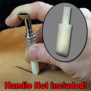

rickybobby Posted November 19, 2011 Report Posted November 19, 2011 Thanks for the picture/info. Where do I find a double beveler? Hey K-man, I have done some of these "quilted" patterns on some projects and used the Craft tool B997 beveler on the lines. I have not checked to see if Tandy still sells them. If you need a picture of it I can take one and post it. Hope this helps, Rick Quote Rick
mlapaglia Posted November 19, 2011 Report Posted November 19, 2011 Hey K-man, I have done some of these "quilted" patterns on some projects and used the Craft tool B997 beveler on the lines. I have not checked to see if Tandy still sells them. If you need a picture of it I can take one and post it. Hope this helps, Rick The B997 is still in the catalog. https://www.tandyleatherfactory.com/en-usd/home/department/leathercraft-projects-old/Leather-Holster-Making-Supplies/6997-00.aspx I have one, Ill have to try it that way. Michael Quote The key to immortality is first living a life worth remembering. Bruce Lee
Members K-Man Posted November 19, 2011 Author Members Report Posted November 19, 2011 Thanks for that info. I'll give the 6997 a try. Quote
