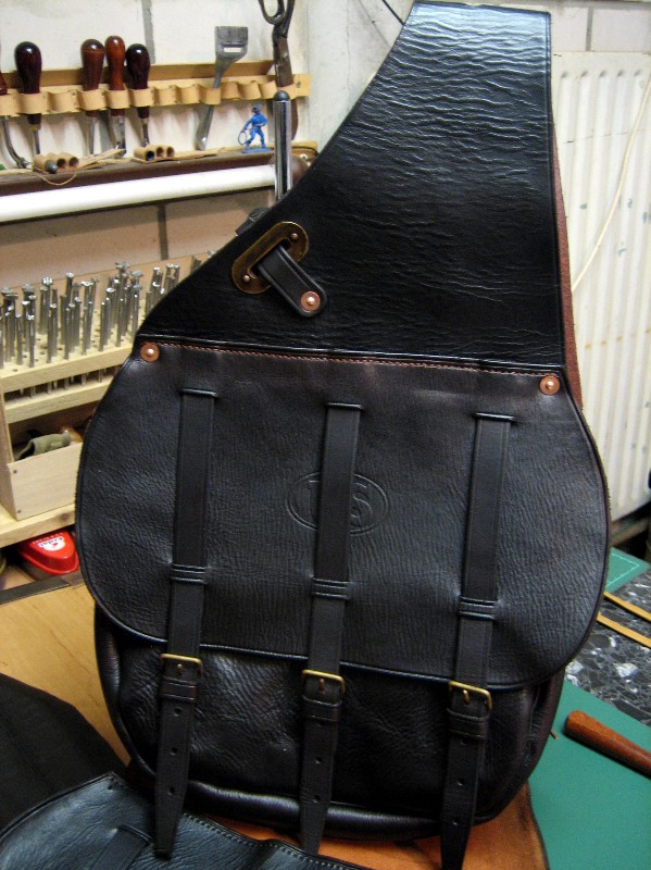

This is a set of M 1884 US Saddle bags that im in the prosses of finishing at the moment, Don

Very Nice Don! :clapping: Glad to see you have been busy. Do they have a liner?
(I'm always fishing for construction tips and tricks :) ) Good work. Thanks for sharing.

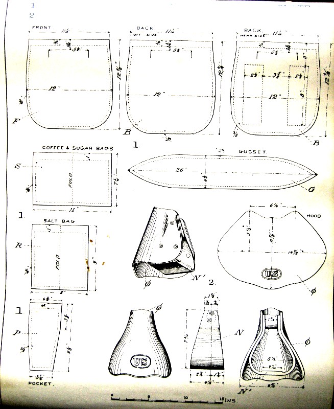

hi crystal yes they will have a liner that buttons in made from canvas material,
I still have to make them, Don

Look neat!! I love this 3 buckle pattern bags. thanks for sharing this official pattern! I'll keep a print, theres even the stirrup hoods :-)
What hide do you use for the part stamped us (sorry i dont know the exact term in english) ? Maybe that just cow that you fold to make the grain like that? It do look beautiful. Do you need to use something like a heavy linen as a lining?

the above patern is for the inner lining ill get the saddle bag patern up aswell, the originals were made from pig skins, but the repro that ive made are from cow hide, the originals also have that wrinkling pattern on them so i rolled the leather in different directions to get the same pattern, yes the linings are a heavy linen like canvas cloth, Don

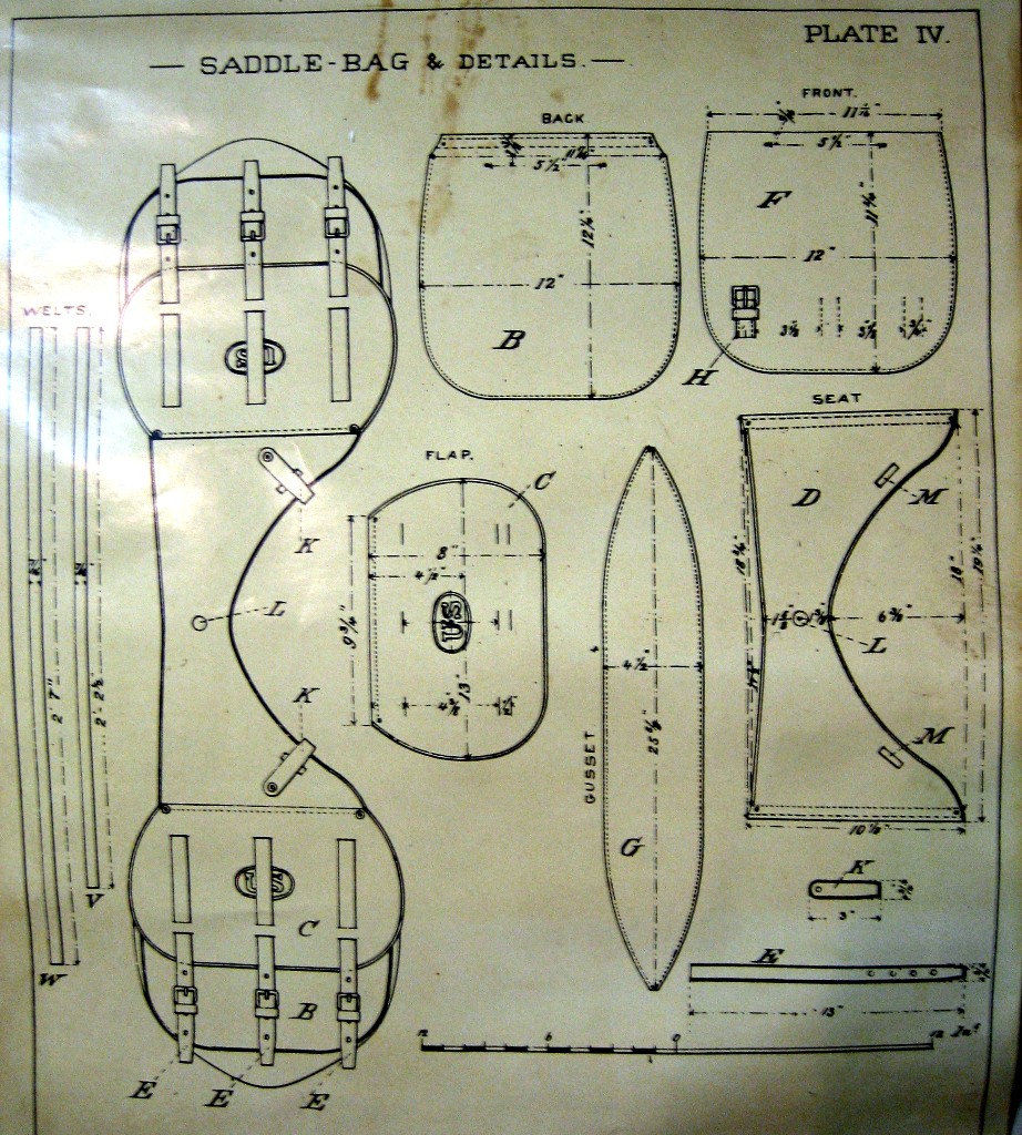

Here are the drawings of the saddle bags
wow! Pattern are nicely done, just some numbers hard to read but well, thanks! I'll probably want to make these bags for my saddle one day. Fun to read pattern with the salt and coffee pocket :-)
They could have placed the "us" stamp to another place, it is hidden by the strap :-/
What weigth did you use for the bag? Leather factory carry a ligth veg-tan pigskin that i use for many thing, good for lining to! It is light, but pigskin is a stiff "springny" leather so could be good to make those bags if best and heavier part is used.
The wrinkling pattern: it look like old english girth hide, J.E Sedgwick still make that kind of print for baghide.
