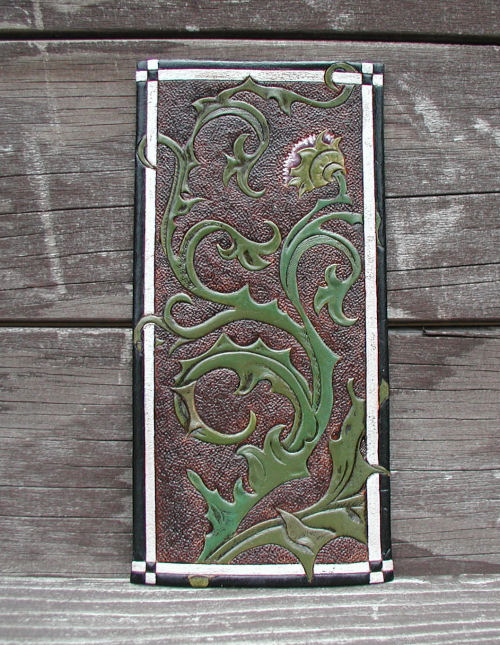

I saw Spider's post months ago, he had done a cigar holder. This is my take on one. It's for the hubby - I hope it is not too girlie.
This is before putting it together.

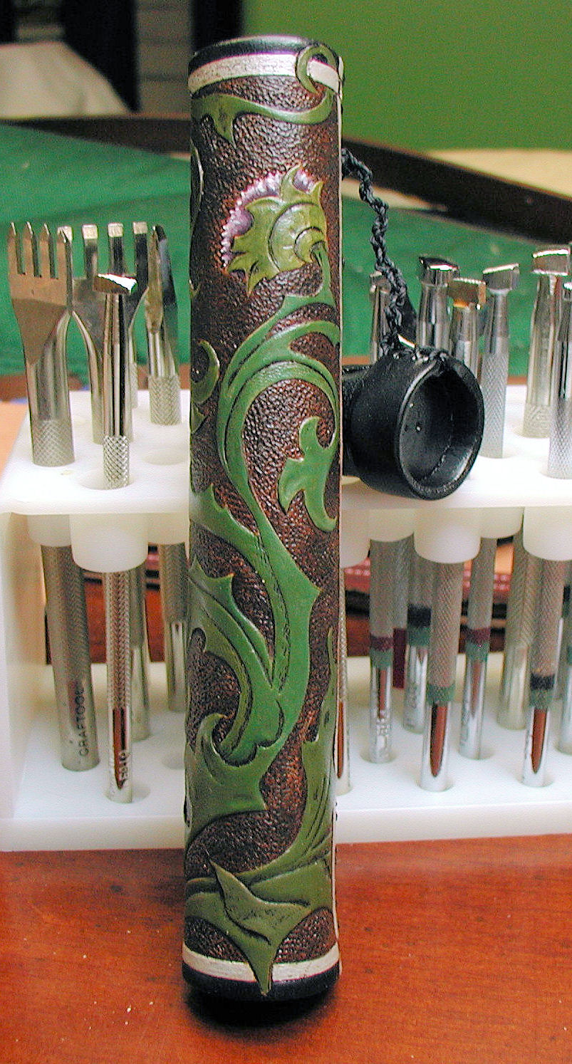

After Construction

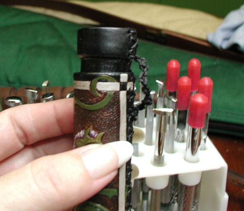

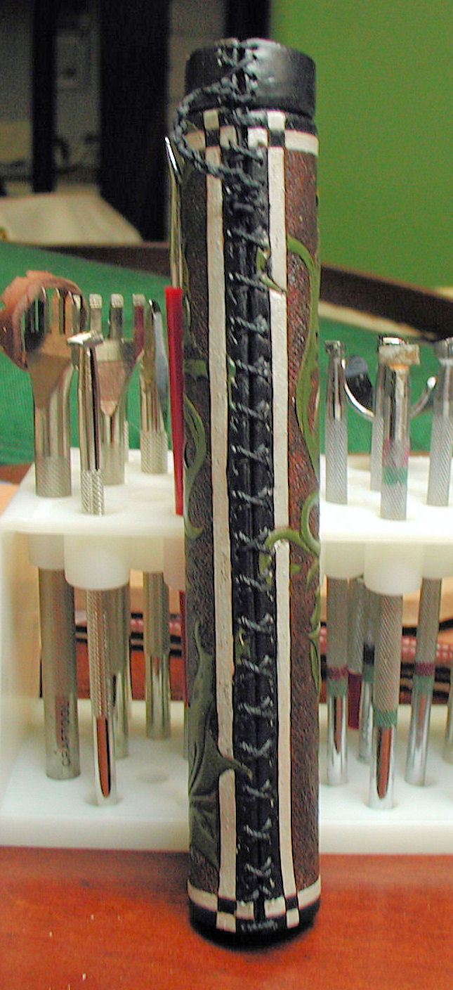

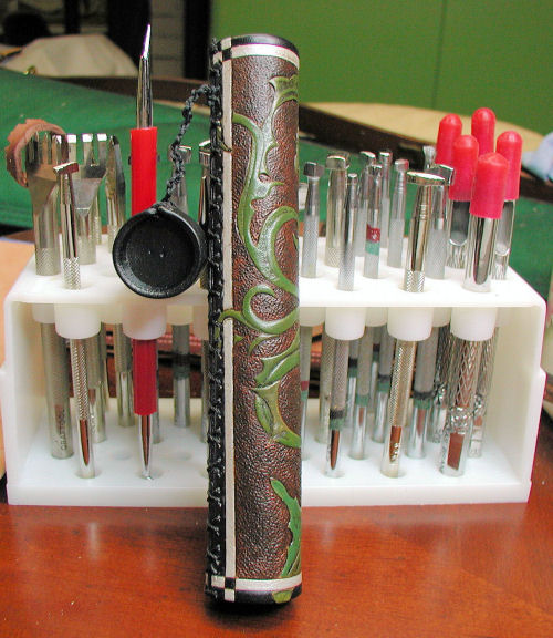

Thanks, Singteck. The cap is like a stopper.Cigar13a.jpgI thought about lining it with the paper thin cedar that comes in some cigar boxes, but wasn't sure if I could wet mold it to get the shape. Then wasn't sure how to glue it in. So there is no lining.Cigar14a.jpgThe cap is 2 pieces. I skived the bottom half to less than 1/2 the leather thickness and for the top I grooved an inside channel to insert the circle piece.Cigar16a.jpgHope this answers some questions. I have no idea what smells, etc might transfer. I did not seal the inside with anything, nor the outside, yet. Crystal
