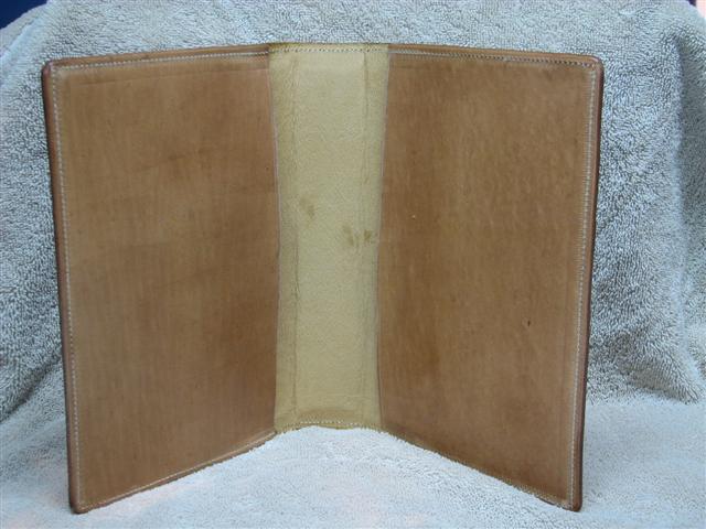

jbird Report post Posted June 25, 2008 Hi Bruce I love your bible covers how do you do the inside can you post pics. Quote Share this post Link to post Share on other sites
bruce johnson Report post Posted June 25, 2008 Joshua, Here are the pics of one I just finished up earlier. I fully line them all. The lining is "lining pigskin" from TLF in the biscuit/straw/golden color. I like it. It is thin and a bit of stretch to it. It doesn't wrinkle too much if glued down well. You can see where a little glue solvent has soaked through at the spine area. That will be gone tomorrow. The pockets are 3/4 oz commercial oak from Siegels. It is a little stiffer vegtan leather. It is lightly oiled and allowed to even out. I seal it with LeatherSheen. I apply the sheen front and back with a sponge. While still wet I go over it hard with my slicker on both sides. It compresses and glazes the flesh side and slicks up the grain side well too. I apply another coat and let it dry. The sheen keeps the oil from bleeding off on paper. I do this for all my pockets - checkbooks, planners, portfolios, etc. I have one out 15 years with no bleeding. I have a little teeny edger I use on the open edge inside that isn't sewn. Makes a nicer feel than the square edge. Glue them, sew them, and then trim the excess and edge all around. Some Bible covers are a little sticky in the slip covers at first. I shake a little baby powder in the pockets, do the Hokey-Pokey, and dump it out. They'll slide then. Quote Share this post Link to post Share on other sites
