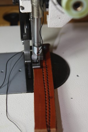

esantoro Posted July 13, 2009 Report Posted July 13, 2009 (edited) I got in my mini bench grinder today and did a bit of grinding. No pictures of these mods yet. Here are some pictures taken of leather limitations with basic mods done a year or so ago. The Monster wheel slipped when the needle was trying to go through two layers of 5/7 thick-skinned latigo. Did the same with one layer of 10/12 bridle. Perhaps it is a good thing that the Monster wheel did slip, otherwise I think the needle would have busted and who knows what else in this little machine that may just try to take on more than she can handle. The Sailrite machines don't have the problem with the MW slipping because they have a pin that solidly and completely locks the MW onto the cam. Prior to this pin, Sailrite used just two allen head screws to hold the MW onto the cam, which is the method I use with my Yamata. If anyone has plans to buy presser feet and feeddogs for these machines from either yamata or consew, please let me know, as I'd like one more presser foot and two feeddogs with which to experiment with grinding down. These parts should be about $9 apiece and $9 total shipping. When I ordered these parts from Yamata, I received one malformed feeddog that was useless. I was a bit irate and didn't feel like paying to send the part back. Finally, today I made good and turned the sucker into a lt. side toe with my new Harbor Freight mini bench grinder. ed Have you done the presser foot mod? Were there any problems, what thickness leather can you sew after the mod?I am asking, because I am looking at the Yamata FS288Z for myself and would like as much info as possible before I buy it Thanks: Jimmy Edited July 13, 2009 by esantoro Quote http://www.waldenbags.com http://www.waldenbags.etsy.com
