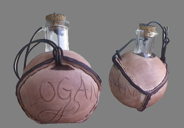

I made this leather covered bottle with it.
post-21513-074809800 1336416333_thumb.jp
This is the 3 section, 3" ball pattern
Posted (edited)
I got them for a dollar each at Michael's. Wal-mart has some similar ones with etching on the "globe" section.

I do like the look of the covered round bottles.
Round bottom boiling flask is out of the TV series Breaking Bad, was not sure if anyone would recognize it.

Those look like round bottom boiling flasks.
Do you watch Breaking Bad by any chance? :)

Those flask covers look like a better way to make a leather bottle. Remove that glass and split that top piece to incorporate a neck. Probably easier than trying to stretch wet leather with barley. :)
