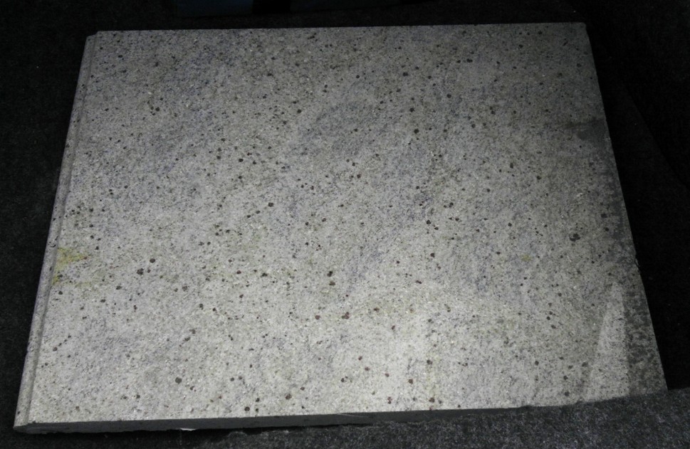

KnotHead Report post Posted August 28, 2012 Okay. Got my first piece of granite from the granite shop around the corner for $60.00 and it's huge and heavy. LMAO!!! See the image. LOL... But at least it will double as a roll out for my braid work. LOL... Now for the poundo board and the rest of the basic tools. Brian... Quote Share this post Link to post Share on other sites
DoubleC Report post Posted August 28, 2012 Hey, you're 1/2 done with your first project and don't even know it Brian :-) Cheryl Quote Share this post Link to post Share on other sites
KnotHead Report post Posted August 29, 2012 Hey thanks Cheryl. I just have to bite the bullet on the Tandy cost for the darn poundo board. I should be kicking my butt for not buying it when I was in El Paso on vacation. LOL... B... Quote Share this post Link to post Share on other sites
DoubleC Report post Posted August 29, 2012 Brian, I had one given to me way before I know what it was for, and have no idea where it is. I've never used one. Actually until this weekend I used a marble cutting board :-) But in my new apartment they left a ton of 'stuff' and some of that stuff was BIG marble pavers. So I have seven of those and used one this weekend. Don't get too caught up in the 'stuff' and just do it. Trust me I know how scary that sounds because I feel that way every time I start a new project still but seriously just do it. OK, tonight, I want to see SOMETHING you did on your granite, a copied and carved design, forget beveling. Or a copied and beveled design, forget carving. Jump in Brian the water is so nice. Cheryl Quote Share this post Link to post Share on other sites
KnotHead Report post Posted August 29, 2012 I don't have the basic tools yet. Just the granite and a mallet that I don't think will be heavy enough. I need to get me some scap veggie tanned hides to practice with also. Wish I could just jump in. But I will wait till I have the things I need and then jump into the fire with both legs. LOL... B... Quote Share this post Link to post Share on other sites
mikesmith648 Report post Posted August 29, 2012 How big is the granite knothead? looks plenty big to me. And as far as a poundo board........I have one and also an acrylic cutting board from WalMart .............I like the cutting board better! JMHO Quote Share this post Link to post Share on other sites
