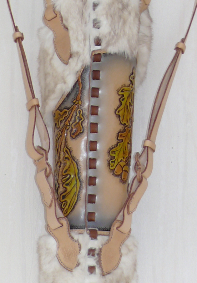

Members Tina Posted January 12, 2013 Members Report Posted January 12, 2013 Here's an idea I made on a quiver, I hope the picture tells the story :-) Quote "He who works with his hands is a laborer. He who works with his hands, and his head is a craftsman. He who works with his hands, and his head, and his heart, is An Artist" http://vildkorpens-laderlya.deviantart.com http://tupali.deviantart.com/
