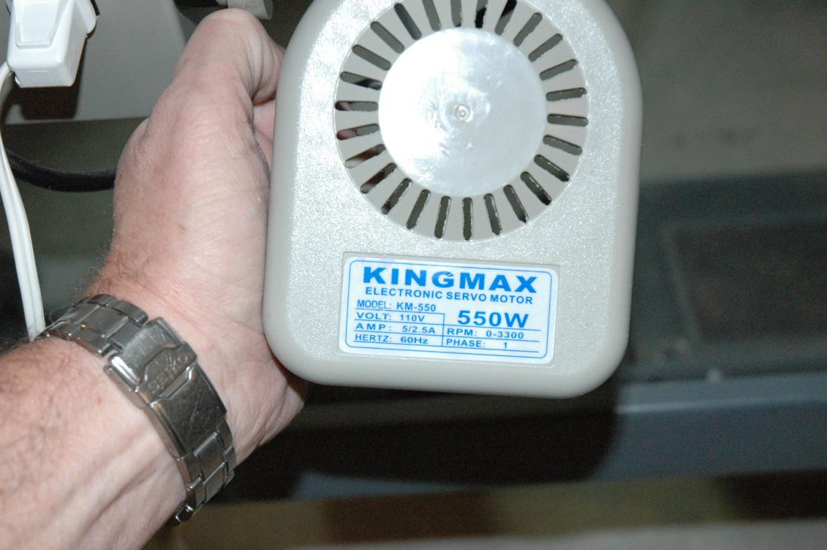

stelmackr Posted January 20, 2013 Report Posted January 20, 2013 Don't know how to really ask this question, so here goes. I have three sewing machines FERDCO Pro 2000 (a.k.a Juki-441), FERDCO 1245 (a.k.a. Pfaff 1245) and a FERDCO Pro 206h (a.k.a. Consew 206). They all have analog (non-digital) speed setting servo motors. Two of the machines (2000 & 206h) stitch when the pedal is pressed on the toe and stop when the pedal is depressed on the heel of the pedal. When the pedal is not depressed the servo motor stops me from using the hand wheel. The same "locking" of the hand wheel occurs even when the servo motor is turned off. I have to depress the pedal slightly on the toe side to make the hand wheel turn freely. If depress too far--it starts sewing. I was told that this is the way the servo's were designed and mimic the old clutch motors. I am no expert, so I might be wrong here. But, the third machine (1245) does not lock the hand wheel when I step on the heel of the pedal or when the servo is off. I like this functionality. OK, OK, now the question(s): "Is there a place to purchase servo motors without the brake action? Can the servo motor be modified or adjusted to remove the brake action? Do digital servo motors have the brake action and can that brake action be removed? Can the brake function be removed buy some mechanical linkage adjustment?" Bob Stelmack www.pslac.org Quote Bob Stelmack Desert Leathercraft LLC Former Editor of the, RawHide Gazette, for the Puget Sound Leather Artisans Co-Op, 25 years of doing it was enough...

Members billymac814 Posted January 20, 2013 Members Report Posted January 20, 2013 Ok this took all of 5 minutes. I removed the end cap on the motor, there was three screws holding it on. This exposes a wheel and you can see in the pictures there's a cork brake pad. There's 2 screws holding it on. I didn't bother to try to adjust it as its directly on the arm that activates the motor. Ill report back if this causes any negatives but I doubt it will. Quote www.mccabescustomleather.com

stelmackr Posted January 21, 2013 Author Report Posted January 21, 2013 Ok this took all of 5 minutes. I removed the end cap on the motor, there was three screws holding it on. This exposes a wheel and you can see in the pictures there's a cork brake pad. There's 2 screws holding it on. I didn't bother to try to adjust it as its directly on the arm that activates the motor. Ill report back if this causes any negatives but I doubt it will. Billy, I believe you have the answer. I'll wait until I can warm up the garage and tackle the two servo motors to remove the clutch as you have indicated. It's just too cold to get try crawling around on that cold cement. I am sure you have helped many others that have the same needs for a clutch-less servo motor. Thanks for your fine pictures that will make it easier to do the same job you did. Bob Stelmack www.pslac.org Quote Bob Stelmack Desert Leathercraft LLC Former Editor of the, RawHide Gazette, for the Puget Sound Leather Artisans Co-Op, 25 years of doing it was enough...
