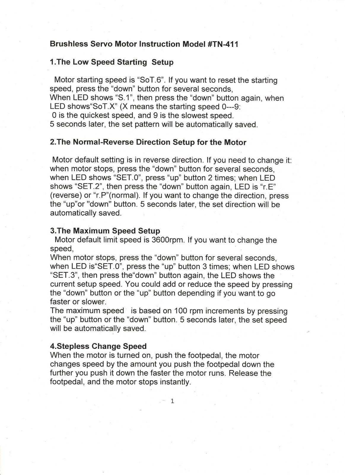

reddevil76 Posted February 9, 2013 Report Posted February 9, 2013 There are two buttons on my motor. Up (a upside down V) and Down (a V). When I hold the down button, it shows 5.0, the next setting is L.0. What does these 2 settings means? Quote
CowboyBob Posted February 9, 2013 Report Posted February 9, 2013 If you have the TN411 motor here's the instructions. Quote
reddevil76 Posted February 10, 2013 Author Report Posted February 10, 2013 Hi Bob, thanks for the attachment. I read through it, but my motor doesn't indicate all these. It just says S.0 to S.5 and L.0 to L.9 Quote
Contributing Member Ferg Posted February 10, 2013 Contributing Member Report Posted February 10, 2013 The default setting on the servo is 5. If the servo is moving fast enough for you just leave it alone. In the event you wish to slow or speed it up just follow the directions Bob gave you with what you are seeing don't worry about the other digits. ferg Quote

Members Xtraordinaire1 Posted May 25, 2014 Members Report Posted May 25, 2014 my servo motor is running in reverse and I can't figure out how to getit to go in the proper direction. Mine has 0-5.3 and L0 - 9. When I was messing with it, I think an R with a # popped up then something with an E. Help $1700 machine that I just got yesterday 5/23/14 Quote
Members J Hayes Posted May 25, 2014 Members Report Posted May 25, 2014 (edited) http://store.keysew.com/parts/consew-csm550 Might find an answer in here, might be the same as what Bob posted above though Edited May 25, 2014 by J Hayes Quote
Members Xtraordinaire1 Posted May 25, 2014 Members Report Posted May 25, 2014 Thank you Mr Hayes. That did the trick. You have beena great help. My manual is in either Chinese or Japanese, neither of which do I read. Have to go back wherei bought it and get an English one. Thanx again Quote
