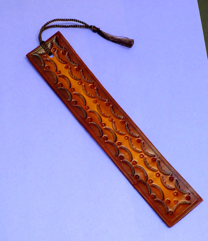

Members tedmont Posted February 16, 2013 Members Report Posted February 16, 2013 I love my airbrush. It is an inexpensive model made in China. I have done hundreds of applications with it. You can get even coloring using it. You can move from a light shade to a dark shade in one application. (see pic). It works well with strong colors, ie. brown. It leaves a very weak color when used with greens, reds. blues, etc. It will not replicate the the colors achieved by dipping your project into dye or brushing on the dye. The airbrush will always deliver something weaker. Then again, you cannot attain the weaker effects by brushing on the dyes. If you don't have one, I recommend it. It is fun. It adds another dimension to your work. (be sure to wear a mask if you do. The colors are made with heavy metals and can make you very ill. ) They are inexpensive. I got a compressor and 3 airbrushes for $130. Quote
