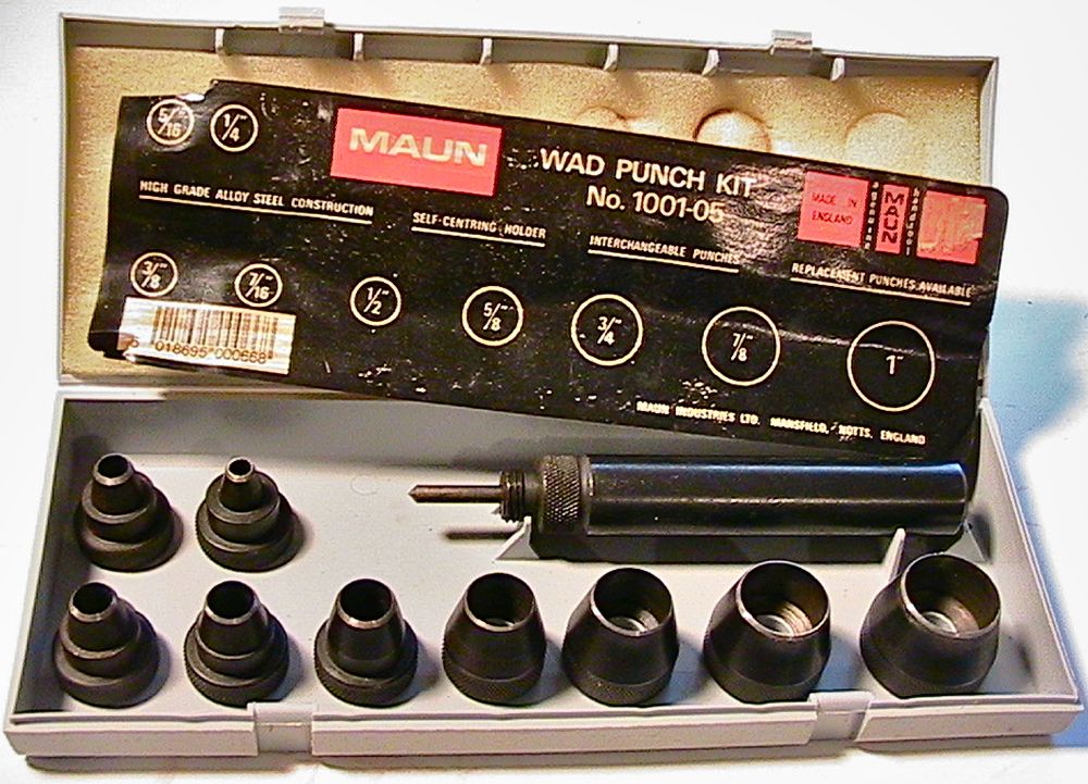

Contributing Member TwinOaks Posted February 24, 2013 Contributing Member Report Posted February 24, 2013 Slick has hit the biggest point here: you need sharp tools to cut things. Look at picking up a few regular hole punches in the sizes you use most. The interchangeable tip punhes are really only suited to punching through really thin leather or vinyl. Look at the end of the punch, and you'll see a very pronounced shoulder to the cutting edge. That shoulder is actually preventing the ounch from getting through the leather. If you grind/ sand that down, you'll have a much easier time. Or....just get an actual hole punch in the correct size, it's a very obvious difference. Here's a pic comparing the two...same size hole: Once you have your hole punches with some proper angles, you'll still need to sharpen it. There's some videos on youtube that demo it very well. Alright...punches addressed. Cutting surface: you need to have a soft surface to protect the punch's edge, and under that you need something with significant mass. The mass under your cutting surface can be as simple as some heavy lumber, a sturdy table, or a block of rock. My set up is a 'poundo' board on top of my granite slab. When I tool, I just flip them to put the padding under the rock. So....what should you hit it with? As much hammer or mallet/maul as you can comfortably use. It's okay to hit it more than once....and that's where the mass under the cutting board come into play. The more mass you have, the more the tool will cut because the energy from the mallet/hammer isn't enough to move it. That means all of the energy is going to be used in driving the punch through the leather. If you try to punch holes on something flimsy like a card table, you'll notice a lot of bounce, and te hole may not be struck through. Quote Mike DeLoach Esse Quam Videri (Be rather than Seem) "Don't learn the tricks of the trade.....Learn the trade." "Teach what you know......Learn what you don't." LEATHER ARTISAN'S DIGITAL GUILD on Facebook.
