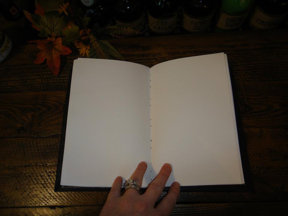

Members ReneeCanady Posted June 8, 2013 Members Report Posted June 8, 2013 This is the journal I made using that video. Quote
