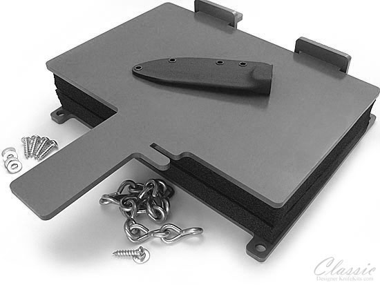

Grunt Posted September 7, 2008 Report Posted September 7, 2008 I am looking to get a press in order to mold holsters and knife sheaths. What I need to know is how big of a press do I need. I have seen hydraulic presses at Harbor Freight in 20, 12, and 6 ton models. Do I need that much pressure? Would one of these presses used to mold kydex knife sheaths work? I make mostly knife sheaths but I would like to be able to make the occasional holster as well. Thanks for looking. Nick Quote
Members K-Man Posted September 7, 2008 Members Report Posted September 7, 2008 You would be wasting your time and money with the one you have pictured. If you're set on getting one of those, let me know. I have one I'd sell to you for say $25 + shipping. It's just gathering dust under one of my work benches. There's a number of folks here who have a variety of styles of presses. Most use what's readily available around them. I use the one offered by Weaver, as it's a space saver model, and you can put a good size hydraulic jack into it. It comes with a 6-ton jack. Quote
