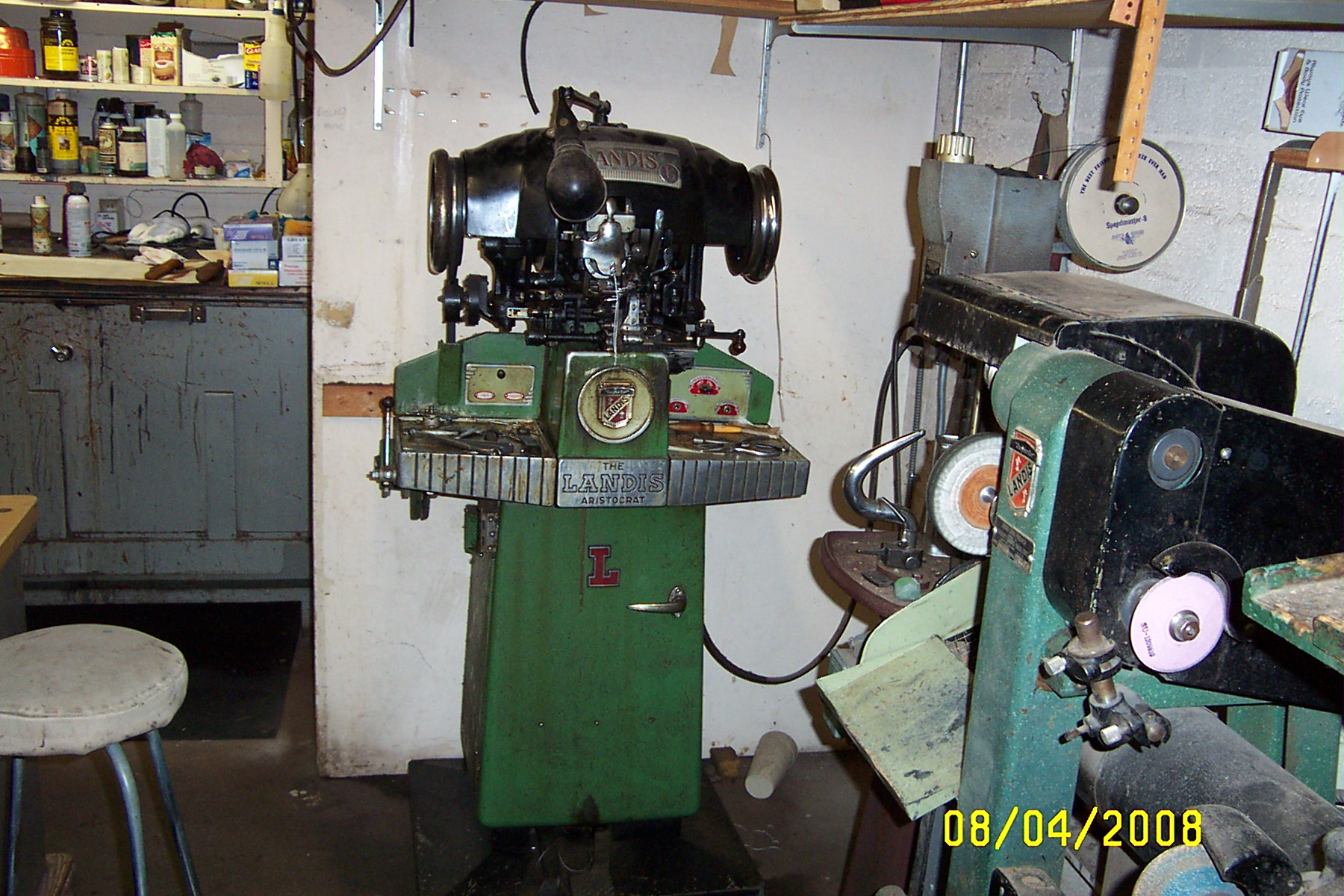

Members Prince Posted September 8, 2008 Members Report Posted September 8, 2008 So I've had this stuff for a few months now, bought it on ebay hoping I could find some uses for it but before I knew it I was buried under deadlines and other junk that popped up so long story short, now I've got commissions back under control and I've had a bit of a chance to organize my shop a bit, clean up the machines a bit and start figuring out what they are and what they do. Hopefully some of you guys can help me figure out what some of this stuff is and what it does and how it works! Alright so now with part two. The Landis thing fascinates me; It's quite large and weighs a ton. You turn it on and the motor starts turning then you press the petal which engages a sort of clutch and then the big 'engine' inside starts turning and metal shite starts moving every which way inside and out. It looks like it's meant to stitch the edges of something (there is no throat to speak of) My guess is the outer rim of shoes and even though I have not plans to make shoes (maybe a couple pairs of boots some day) I figured it would be a sheath maker's dream; just stick the 2 or 3 pieces of the sheath in there and let it do it's work. Also for bags and belts and stuff too. It looks like it sews with 2 curved needles and one seems to be broken on mine and then there's a bobbin too which means 3 feeds of threads. I'm a novice at this stuff so it makes my brain to explode thinking about it. How does that even work? And can I adapt it for the uses I have in mind? Maybe others? In spite of it's appearance of complexity it seems like it's over engineered to be solid and unbreakable even though it sounds like it's gonna break with every clankity-cla-chunk when it's going 90mph. And by they way, that's it's only speed unless you wanna idle/slip the clutch thing a bit (probably bad for it) and it's momentum keeps it going for quite a few clankities after you release the clutch. I suspect it was made before electronics dominated the world. Kind of reminds me of a steam locomotive. I'm sure I'll have to request tips for how to thread the thing when I get around to doing that cause I haven't been able to find a manual for it online or off. O yeah, and heat... what the heck is that for?? It has a heat control; does the motor get really hot or something? Even so, what exactly would it do to regulate the heat? Or maybe if your in cold areas and the oil needs to be warm enough to flow? I really have no clue. Next is the Sutton thing. It looks to me like a stitcher of some sort... certainly an atypical one, but one none the less since it's got thread and all so what else would it do? Since it's for shoes the only thing I can think of is that you could stick your shoe over the post and stitch away in awkward freedom. Again, not caring about shoes I imagined being able to sew odd shaped things like leather helmets, elbow and knee armor sections, weird shaped bags, and overlays on already shaped leather armor. Maybe other stuff if I can think of it. Think this is possible? Any other ideas? Tips and clarification would be greatly appreciated!! As a more general question; is it impossible to invent a dual feed thread input that would replace/remove the bobbin? I assume it must be or they'd have made it happen by now. Quote Elaborate Custom Armor, Weapons, And Leather Items at PrinceArmory.com | My DeviantArt Gallery | Facebook |

Members Kevin Posted September 8, 2008 Members Report Posted September 8, 2008 I'll try #2 now. The Landis is a curved awl machine. The shoe is placed sole side up on the "work table", the awl comes up, makes a hole, then the needle goes down through the hole and picks up the thread. I think I've seen a manual for this, but if you can't find one get hold of Shoe Repairing by Henry Karg. This has some diagrams and troubleshooting section. It also has a straight needle machine, patching machine and a metallic fastener (nailer that uses wire). It also has business tips such as, "It should not be a meeting place for idlers,but one that women and children will enter without hesitancy." The heat is for the wax that the thread runs through. Linen thread soaked up the wax and the wax sealed the stitch holes and made the thread into "pegs" that held everything together even after the thread was worn through on the surface. Now there is liquid wax that performs that function and works very well. On harness machines, they had a gasoline burner that kept the whole machine hot or the wax would solidify and break the thread. Sorry, but I don't know anything about the other machine other than I think it does a McKay stitch. Kevin Quote

Members Randy Cornelius Posted September 12, 2008 Members Report Posted September 12, 2008 You have one of the true "TANKS" of the sewing industry. I have one as I thought I would get into making boots. It will sew belts, holsters, anything that has an edge to sew. Do not try to sew saddle skirts. The wool will get wound up on the awl and you will have a mess. Yours is just like mine and I have the orginal manual that I would be glad to copy and send. Parts and everything are still available through Pilgram shoe. Also any shoe repair supply company will have needles and awls. Good luck it will be an adventure. Find a shoe repair shop close to you that may have one and pick the guys brain on working on this machine. The heat was for when they would put solid bee's wax in the wax pot and melt it to lubricate the thread. Quote Randy Cornelius Cornelius Saddlery LaCygne, Kansas Randy & Riley Cornelius Ride Hard, Shoot Fast and Always Tell the Truth...
