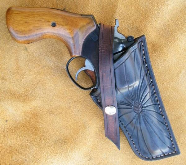

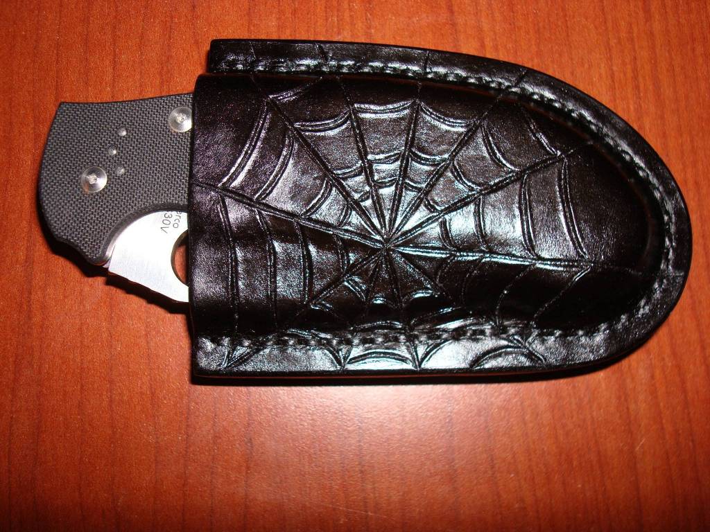

Because holsters and sheaths are all different shapes and sizes I don't think you will find a carving pattern for a spider web specificaly for a sheath or holster. What I do is use my patern and draw an outline on a piece of paper then look at drawings of spider webs on the net and draw the web to fit with in the outline of the holster or pattern. For the most part I draw out the pattern on the leather lightly with pencil then use a swivel knife to cut the lines then bevel those cuts. Here are some examples that may get your creative juices flowing.
post-15001-0-59349100-1375314126_thumb.j
post-15001-0-80069900-1375315100_thumb.j
