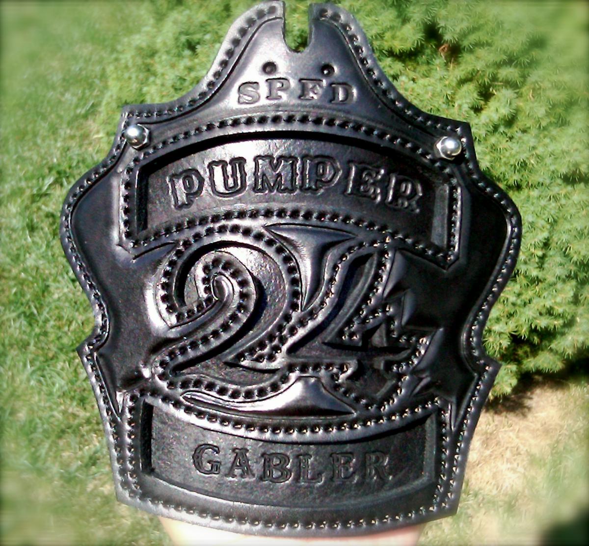

Members bwillielv Posted August 6, 2013 Members Report Posted August 6, 2013 I am a firefighter and am looking to make a new shield for my helmet. I found a design I really like and unfortunately the guy isn't making them anymore. I bought a starter kit and some 7 - 9 oz veg tanned leather. I am learning the basics but have one question about the design. The cuts around the stitch area, the inside area looks like it is pushed up. I can't figure out how to make a cut look beveled like this. Any ideas? Thanks Brian Quote
electrathon Posted August 6, 2013 Report Posted August 6, 2013 The leather is two layers thick. The top layer has "windows" cut into it. Quote
Members bwillielv Posted August 6, 2013 Author Members Report Posted August 6, 2013 I knew it was two layers but it looked to me like that was all done in the top layer. Thanks I will toy around with it and see how it goes. Quote
Members Cyberthrasher Posted August 6, 2013 Members Report Posted August 6, 2013 it's just the result of the beveling. It gives the illusion that the leather is pushed up, when in all actuality it's the same level as the rest of the leather. Quote

Moderator immiketoo Posted August 6, 2013 Moderator Report Posted August 6, 2013 Brian, the techniques used are a swivel knife cut around the shape, and then beveling around the cuts. You could use a beveler for this, but I have created this effect by using pear shaders. Its pretty easy actually, and the shapes I see here definitely would fit a pear shader. Wet leather is like clay, and while you are pushing the leather in one direction or another, it will actually raise the surface as more of the collagen is pushed into a new area. I think if you practiced a bit you could replicate this easily. If you want, I'll take pics of the guitar strap I did that is similar to this. Quote

Members Cyberthrasher Posted August 6, 2013 Members Report Posted August 6, 2013 That would be great if you could take some pics. I have tried many ways to replicate it and just can't seem to get the same look. I wonder how deep I should cut and how wet I should get the leather. Should I let it soak for awhile? Try to keep it properly cased. I have a feeling that a lot of the effect you're missing when comparing to your own work is simply the optics from looking through the lens of a camera. A lot of times that can play tricks on us. There's some of my work that people think is inverted just because the camera is playing tricks on them. I will say that this looks like it's a B200 beveler if that helps. It really doesn't look like a pear shader to me. Quote
Members oltoot Posted August 7, 2013 Members Report Posted August 7, 2013 (edited) The order of work is important, too. I would try this 1) Cut top piece a little oversize, then swivel knife work, then cut outs, mark inside of cutouts lightly on back piece for alignment 2) Let both pieces dry thoroughly 3) glue top to bottom 4) Sew, using swivel cuts as reference 5) Wet assembly then mark and cut exterior 6) When assembly is cased, do bevel work 7) Dye and edge Edited August 7, 2013 by oltoot Quote
