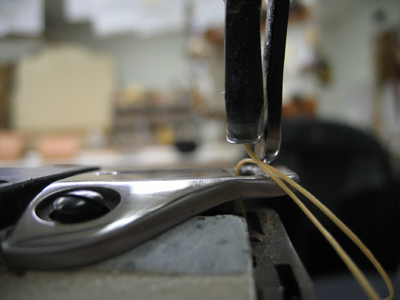

Randyc Posted September 17, 2008 Author Report Posted September 17, 2008 (edited) I wouldn't go that route unless you want the material to slip and the stitching to get spaced unevenly. Still, the folks from Artisan know a lot more than me so see what they say about it. Thanks, Jeff your correct. After I mentioned adjusting the needle bar, I thought it through and decided that wasn't a good idea. I was busy cuffin and stuffin the bad guys today and didn't get a chance to edit my post. I molded a holster over the weekend and was able to smooth out the indentation made from the needle bar skeg. I may just leave well enough alone. If I do decide to remove the skeg, did you use a dremel tool when you removed yours? Randy Edited September 17, 2008 by Randyc Quote Randy Cooley Bulldog Custom Gun Leather www.bulldogleathercompany.com

Members greg gomersall Posted September 17, 2008 Members Report Posted September 17, 2008 Elton is right the only thing sticking out from the bottom of your your needle bar is a needle. Please read your owner's manual closely if you need more clarification. this skeg works like the pricker feet did on alot of the old machines did, to help seat the stitch and yes it can cause problems when starting or turning, your machine will not even notice it missing if your grind it off. I use to have a 205 Adler that had a groove in the needle plate for the bottom stitch to lay in as it moved back, this can be filled in ( i used silver solder) which will help push the bottom sticth up in as well on these machines. Greg Quote
Randyc Posted September 17, 2008 Author Report Posted September 17, 2008 (edited) Elton and Greg Thanks for your inpute. After studying my machine and manual, I found my machine has 2 presser feet. The part I refered to as the needle bar is a center groover presser foot that is attached to the needle bar with the needle passing through this foot. The other presser foot is a left side walking foot. The groover at the bottom of that foot directly below the needle bar is the one that is a problem. I think I may just file if off. Randy Edited September 17, 2008 by Randyc Quote Randy Cooley Bulldog Custom Gun Leather www.bulldogleathercompany.com
Members greg gomersall Posted September 17, 2008 Members Report Posted September 17, 2008 Grind or file it off. Greg Quote

Moderator Art Posted September 17, 2008 Moderator Report Posted September 17, 2008 Hi Randy, As you have found out, part names are important when talking machines. The needle bar is a rod that the needle fits into and by which the needle is propelled up and down. On smaller machines this bar or rod may be adjustable for length and this adjustment is used to time the needle - shuttle/hook relationship. On larger machines this is not usually the case and timing is done by adjusting the shuttle position. The inside presser foot is generally the foot with a hole or slot in it and often the aforementioned skeg on the bottom rear. This part usually attaches to it's own bar or rod and is actuated independently of the needle bar and is also spring tensioned. The purpose of the inside foot is to stabilize the work, assist somewhat (but not much) in the needle feed operation, and to keep the work from flagging as the needle goes down and up. The skeg serves the function of pushing the completed stitch down into the work and additionally similar to a boat causing the stitch to run straight without a lot of operator input. This is only really necessary at high speed, where the operator reaction time might be a lot slower than the machine. Removing the skeg will not cause many problems because of the machine speed we use in leatherwork. When removing this skeg, go slowly with hand tools and relieve any sharp or even semi-sharp edges you might generate (pay attention to side/bottom junctions) and then polish with crocus or a buffer, the smoother, the less chance of marking. Art GregI'm dangerous with a Dremel. Think I will use a hand file!!!! Quote For heaven's sakes pilgrim, make yourself a strop!
Contributing Member rdb Posted September 17, 2008 Contributing Member Report Posted September 17, 2008 As usual, thanks Art for sharing your machine knowledge. I'm no genius at machine sewing, but I kind of like the skeg on my 3000. I usually groove both sides for my stitching, and between the inside presser foot, and the skeg, the stitches are tight, and below the top of the leather. Things I have seen without this approach show wear on the stitches in very little time. They don't look as good either. I sew fairly slow, and the little groover skeg seems to keep the track in the groove. I do have problems at starts, and finishes, and around tight corners, but being careful and slow leaves little marking. Just my half penny... Quote Web page Facebook
