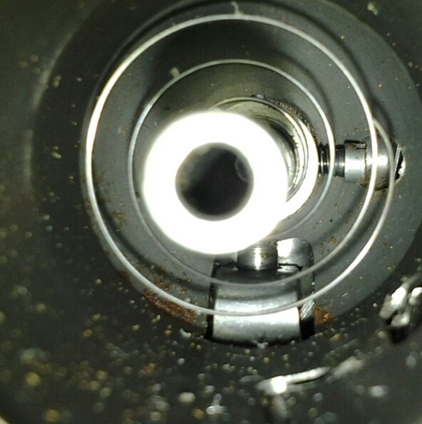

Members ec2121 Posted September 5, 2013 Author Members Report Posted September 5, 2013 ok, i'm not sure if i understand you correctly but there's two scews inside the bobbin one smaller than the other. the larger one goes all the through the shaft thats in the middle of the bobbin...is that the screw your reffering to.??? Quote
Members ec2121 Posted September 5, 2013 Author Members Report Posted September 5, 2013 also the spring seems flimsy to me but is that how it's suppose to be...? Quote
Moderator Wizcrafts Posted September 5, 2013 Moderator Report Posted September 5, 2013 We have a failure to communicate. The spring that sets the tension is on the outside of the bobbin case. You can see a photo of it on this web page - for the Adler 205-370 compatible model HAD-204 Large barrel shuttle hook. The spring you photographed is a beehive internal spring used to help eject bobbins from the case. Did you get an owner's manual or any documentation with your machine? Quote
