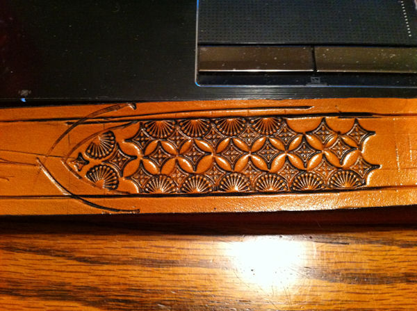

mlapaglia Posted November 23, 2013 Report Posted November 23, 2013 (edited) Here is an example of using a resist to protect the leather and they using an antique gel to just color the depressions of the stamps. First is just the pattern and then the pattern with an antique jell. Its another way to color the stamped area. Keep in mind, these were test pieces when I was first learning. Edited November 23, 2013 by mlapaglia Quote

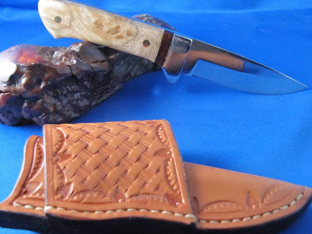

Members camano ridge Posted December 6, 2013 Members Report Posted December 6, 2013 (edited) Like Bob said oiling darkens all the leather you do get a little contrast in the tooled areas but not to the extent you get with antique or High lite. It takes a little practice to do the antiqueing right so it does not look like puke. However it is not difficult and is used by Chan Geer and others with far more expertise then I have. If I am not mistaken and Bob can correct me if I am wrong. I believe Bobs Avatar is a very good example of antiqueing. Attached is a picture of a knife sheath I di just usin oil and suntanned for a few hours. Also a picture of a saddle bag I am working on theat is done with Saddle Tan High lite. Sorry I ran out real quick and snapped a picture for this post so the lighting is not that great but i think you will get the idea. Edited December 6, 2013 by camano ridge Quote
