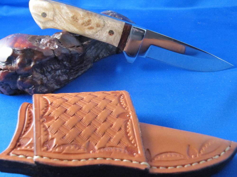

I agree there may be better wheels out there the ones I use are from 40 years ago. The slant to your hole comes from positioning your diamond awl when you pierce your hole. I usualy position my awl so that top (or apex) of the diamond is turned about 20 - 45 degrees to the right of my stitch line. My stitches usually end up looking pretty straight. Here are a couple examples where you can see my stitching. Just to be clear I am not saying there is anything wrong with pricking irons many people use them and like them. I just have never needed to use one.

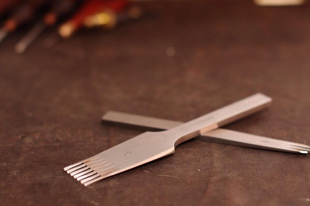

Chinese iron and vergez are very different tools.
Vergez are forged (tool steel), hand hammered to shape, case hardened and filed by hand by a craftsman. The cost is in the skill and quality of the tool. Apparently it takes 3 people and a few hours to make..
Chinese iron is made by machine most likely with stainless, maybe case hardened. The vergez are for professional use, just like how japanese hand planes need to be tweaked for use the vergez teeth are left for the customer to polish and tweak.
Both are reasonable in price looking at what goes into the irons.

With a Chinese worker, you can discuss the steel they use. You can use any kind of steel as you want as long as they can get it. For professional iron, they machine shape first to be very precise and then hand polished or what you called tweak. I tried to polish my formal iron but it took so so so much effort and I can't do it very good. Chinese now make low end and high end pricking iron from different workers and the quality and price are very different. You can get a pair of $10 or $100 or $300. At least ten Chinese workers are making very good irons and they are very well known among Chinese leather workers. I know there are also very good Japanese and Korean workers out there. I didn't see anyone in USA make these tools and I just want to share this info to more people to let them know there are choice other than Blanchard.

The teeth from Blanchard and Chinese one. One is $230, other is $100. This is why I did not like my Blanchard, I was disappointed when I got it. But I understand Blanchard has to pay more to worker. And they have a big brand. But if I knew this, I would not buy. I want a good tool, not a branded tool that does okay.
