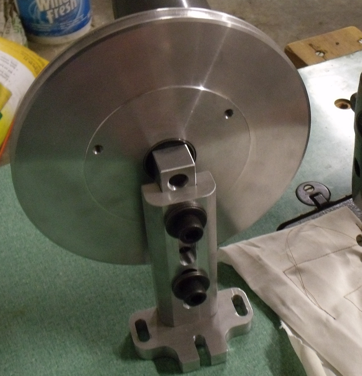

@ SARK9 - holy cow, what a reduction. :blink: What diameter has the large pulley? Or is is just looking big?
I like the mount very much. I wanted to have a similar one but then I found the old sewing motor mount in my parts box. It works and cost me nothing.
I think that one is about a 9.75"--2" on the O.D.'s... Occasionally we get a nice "slug" like that left over from machining a big hole in thick plate. One of the extrusions we use also leaves a nice scrap which makes a telescoping mount pretty easy.

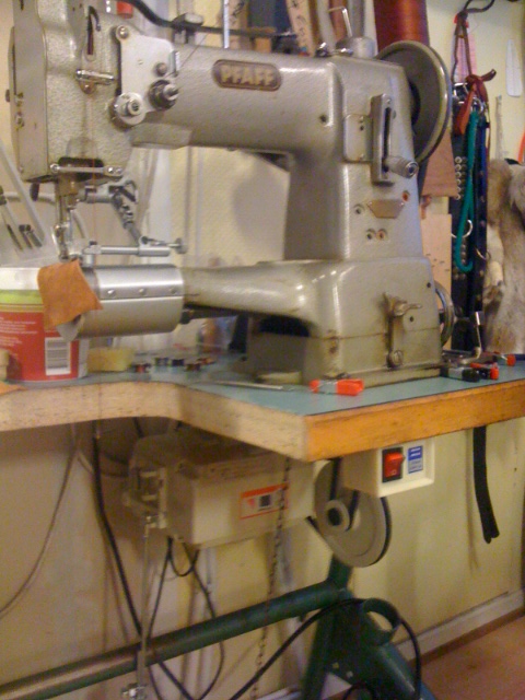

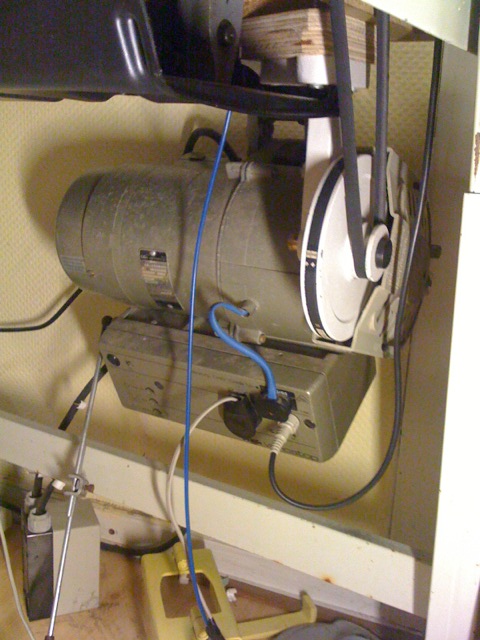

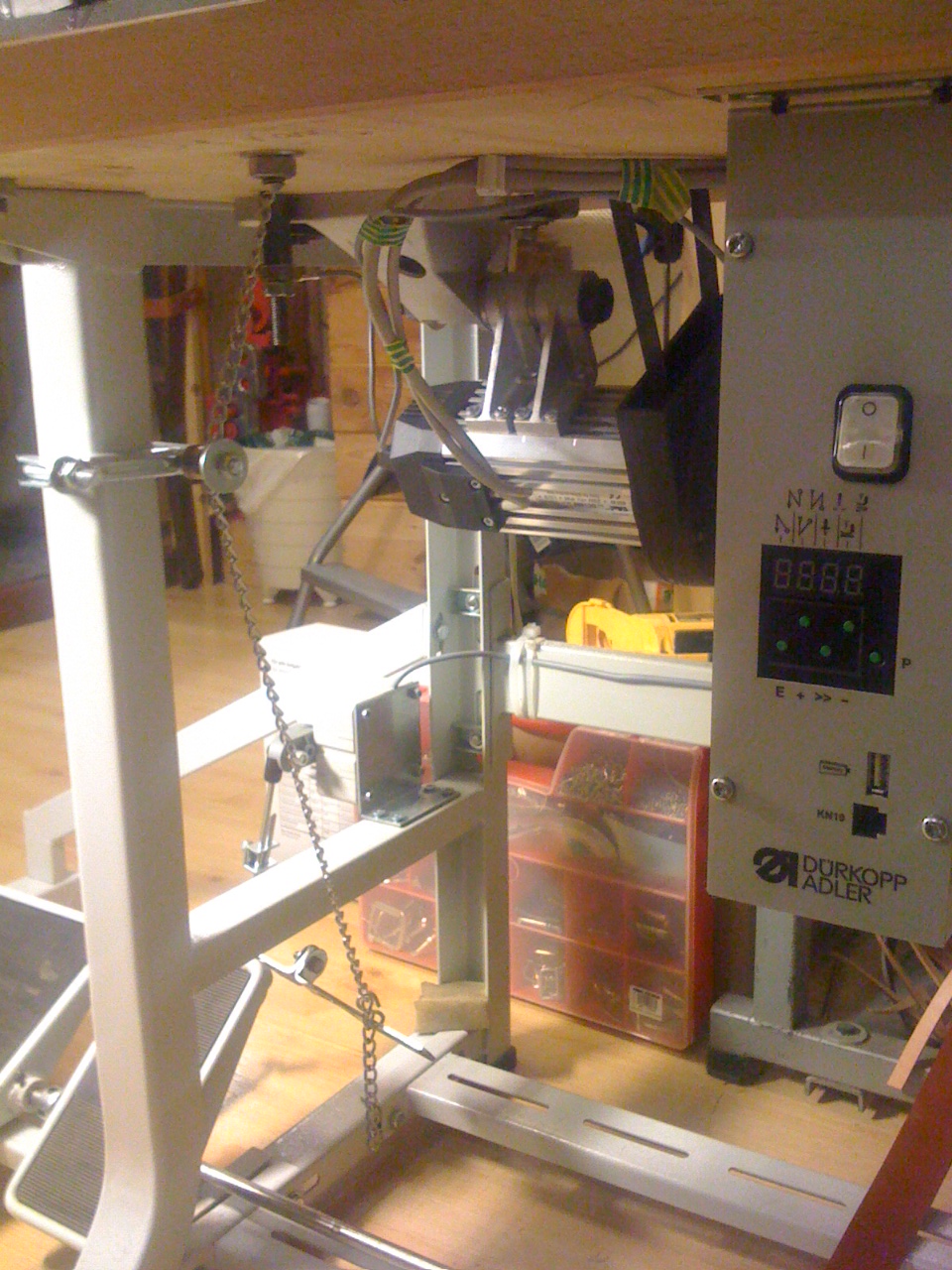

I want to show you how one of our members built a speed reducer, I think he used a washing machine pulley. And this was some years ago before others made this same system. (I am not sure when exactly)
Next: a Swedish Cobra owner living on a boat with limited space available, this is a good way to mount a new motor. A better way would be using the same belting they use on Harley Davidson custom bikes; toothed belts and pulleys.
Next: my Efka/441 setup; lots of space here.
Next: My old Adler 204/ Efka variostop (sold); not much space here, I had to improvise. It does not look any good, thought.
And last my Pfaff 345/cobra and reducer; motor are strong enough without the reducer. I do not know why I used a reducer; I think I was not satisfied with the low speed part of it. (Its now fixed with some tape in the light control; it lost some speed but are much better)
Last pic`s: my 441, Pfaff 345 /cobra servo, Efka DC 1600/DA 267-373 setup, the DC 1550 I use on my 441 clone.
Well it was a bit of a side step; nevertheless motors are closely connected to the reducer topic.
Thanks
Tor

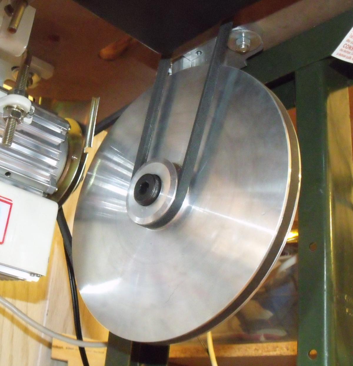

I like seeing everyone’s speed reducers. I came up with an 11” x 2” step pulley that I’d like to put on my H-leg stand that I have my Singer 111G156 in. I’ve got to find a bracket for it yet, or have one made.
CD in Oklahoma

Why such a large pulley? Is it really necessary?

Constabulary:
“@ CD
Why such a large pulley? Is it really necessary?”
It’s just what I’ve found. Larger than needed, but should work alright.
CD in Oklahoma
