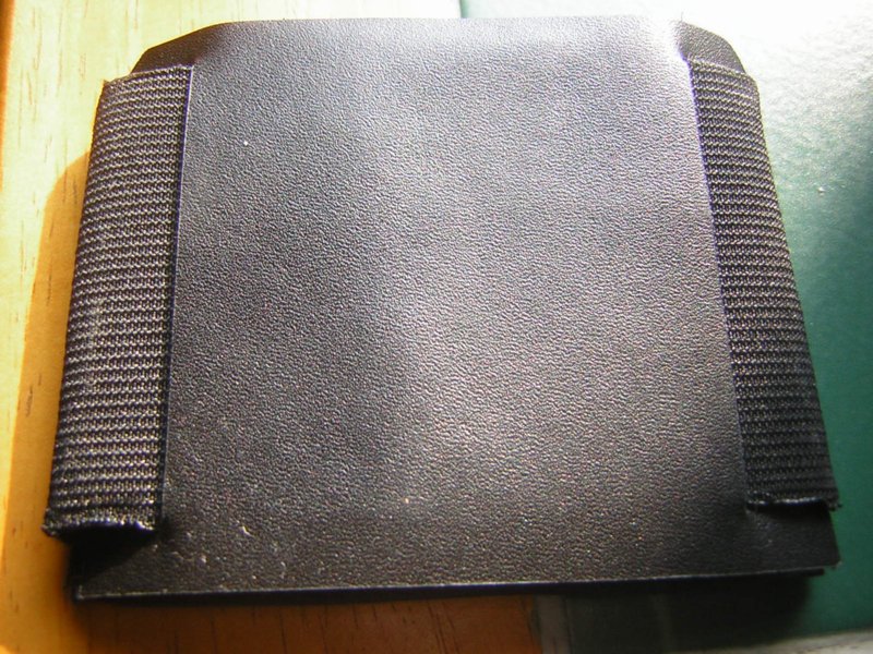

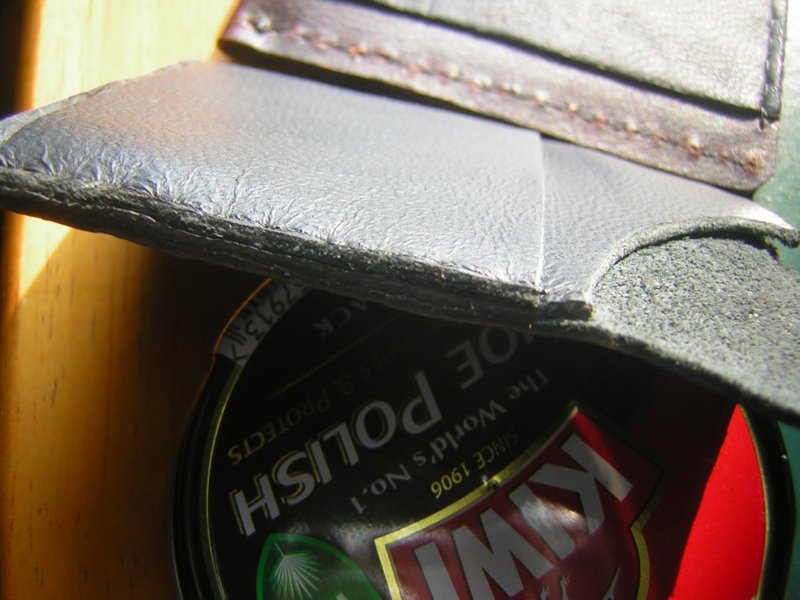

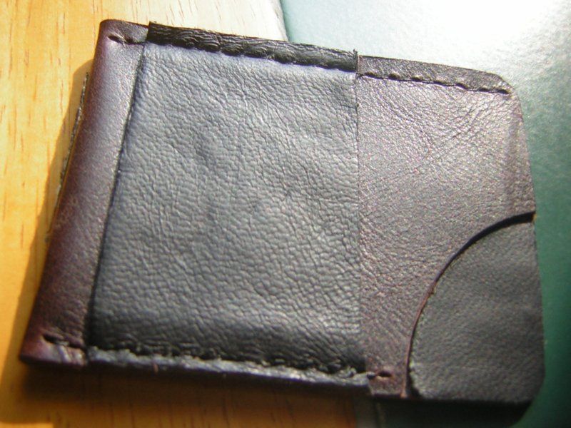

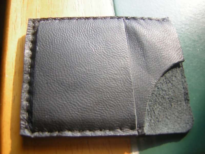

Posted (edited)
Thanks again everyone.
Just about to go take some snaps. I'll try and put some indicators on some of the pics to show the areas I'm unhappy with / don't like.
Images 1 and 2: (as 3 and 4) but made entirely from the 1mm sheepskin. Edge slightly better, but the floppy / soft properties of the sheepskin creates a 'flimsy' and cheap appearance.
Image 3: Card holder with cash strap. One piece of 1.5mm cowhide folded in half to form main pocket. Frequent use card holder pocket on front, cash strap on back. These additional parts are made from 1mm sheepskin.
Image 4: Shows the edge of the cowhide card holder. Glue can be seen between the leather's edge and stitching. Don't like the untidy look of the edges.
Images 4 and 5 are about the closest I've come to success. They are made from 1.5mm cowhide and elastic. I used my mum's sewing machine (which just about managed the job). It looks okay-ish on the surface, but is untidy inside where I had to construct elastic loops half way down the main body of the elastic, in order to stop the cards falling right through (the main elastic is just one loop which is stitched to the front and then fed through slats cut into the back piece of leather.
Also, getting the correct leather is proving almost impossible. My nearest Tandy is 150 miles away and I don't know of anywhere else that sells leather. This means my only option is online sellers and the images they provide.
If I get leather that gives me the firmness I want, it's too thick. If I get leather that gives me the thickness I want, it's too soft and floppy. I'm not in a financial position to start going to tanneries to ask them to thin leather for me, so please don't suggest that as an option.

The problem is not your ability it is the materials you are using. I would recommend scraping cash together to get some veg tan leather and have a hand at edge burnishing, you will also see a big leap in quality.If you must use chrome tan leather skiving the edges and rolling the edges will make a big difference.
I also have a shipment coming to me from the u.s for kip leather (stiff vegtan leather - 1mm-1.2mm)

Ourjud, thanks for posting pics. Your desire to achieve a look that you want is not snobbish, it was the general attitude of your post which you have clarified. I won't be long winded on this one. With the pictures you posted it gives a better idea of what you are trying to achieve. What size thread are you using both hand and in the machine? On the item in picture number 4 you said it is cow if it is veg tan try some sand papar on the edges. You will be able to smooth the edges and remove some of the sqeeze out from the glue. Then try burnishing the edges, if you don't have a proper burnsher for right now you can use a hardwood dowel or plastic rod. Dampen the edges and then rub like heck (don't apply a lot of pressure) you are creating friction to burnish the edge. You will not achieve your ultimate goal with the project you have there, however you can use it as a practice piece to improve the things you don't like about it.
Edited by camano ridge
Yep, veg tan will give you better results. Have a look at Nigel Armitage's YouTube video of small wallets if you haven't already - it'll give you an idea of how much 'better' veg tan is to work with.
Posted (edited)
I will pile on here and say get a veg tanned hide as well. In those first three pics that chrome tanned goat is the problem, as you get to the last wallet, things improve dramatically!
So a better material, some edge refinement and hand stitching and you are there.
Don't give up you are very close. I second the Nigel videos. Go on You Tube and watch all of his project videos. You will pick up a ton of tips and can converse with him as well
Good luck man

Posted (edited)
Thanks.
Incidentally, the cowhide I mention is pull-up... don't know if that's the proper name for it.
As I've said before, the reason I've avoided veg-tan is because it seems to be very difficult to get it pre-dyed. Sure, I could dye it myself, but as far as I can gather from other posts on the subject, it doesn't stop there because it would then need to be sealed and whatnot... this is just more expense that I don't have the funds for.
camano, not exactly sure what thread I used. It's just some nylon stuff my mum had. I'm a fairly strong guy, but I can't snap it with my bare hands, so figured it would be suitable. I do have some 0.8mm tiger thread, but it gives too 'chunky' a finish for my tastes.
If I had made this, I would be as pleased as punch. I love the look and design (yes I know the stitching is very obvious, but it works). Perhaps someone could tell me what type and thickness of leather he's used. It says in the description on the website that it's made from a single piece of leather, but I just can't fathom the construction.

The recent pic you posted looks like perhaps 3oz oil stoned hide ( different folks call it different stuff). The biggest issue I see with your original product is hands down the edges everywhere. The stitching looks god, but the edges being rough, glue showing and lack of quality leather is what I see when I view your product.
