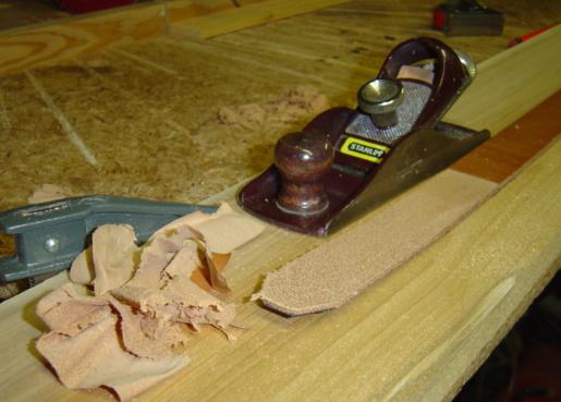

I use a block plane.
post-19342-0-77021500-1399855663_thumb.j
that would probably be easier too. how do you taper with it?
If you're using a block plane and you want to skive say 3inch length. Using the block plane on the first half inch, then an inch etc... with each pass move back 1/2 inch of so.. the successive passes will give you a taper.
I take the belts down with the plane and finish them with a drum sander in a drill press.
If you want more of a taper just take more material off in the area you want thinner and finish by sanding.
I'll start off with the bade barely touching and when it stops removing material I'll drop it down just a little more and keep planing until I have the thickness I want.

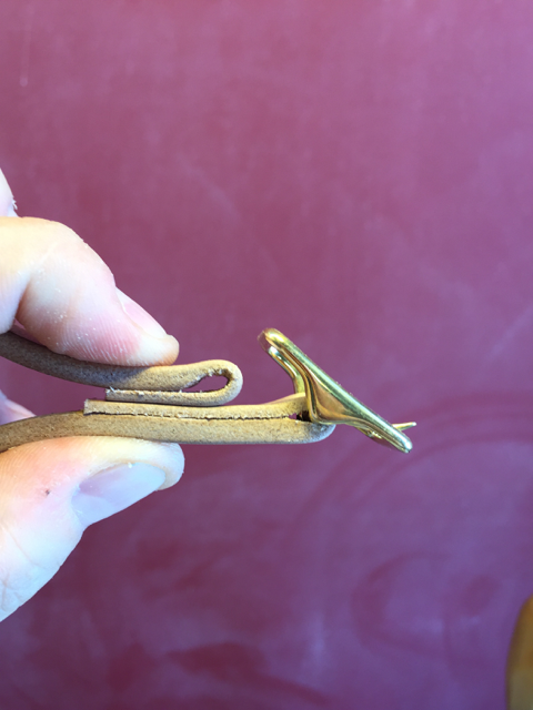

Is this what you mean?
post-45824-0-90576900-1436297430_thumb.p
Bench splitter (bottom) in 2 seconds or skiving knife (top) in a few minutes:
