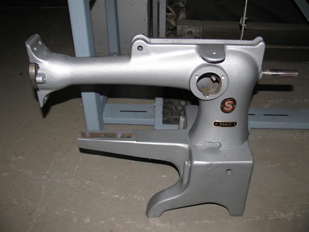

I finally found a cobbler machine with a short arm - not easy to find over here. Just paid 40€ but it needs a general overhaul but thats what I expected. One of the former owners messed up the needle bar... :devil:
So here are some pictures of my restoration:

I made some progress already but I have to order some parts which are either rusted or just messed up

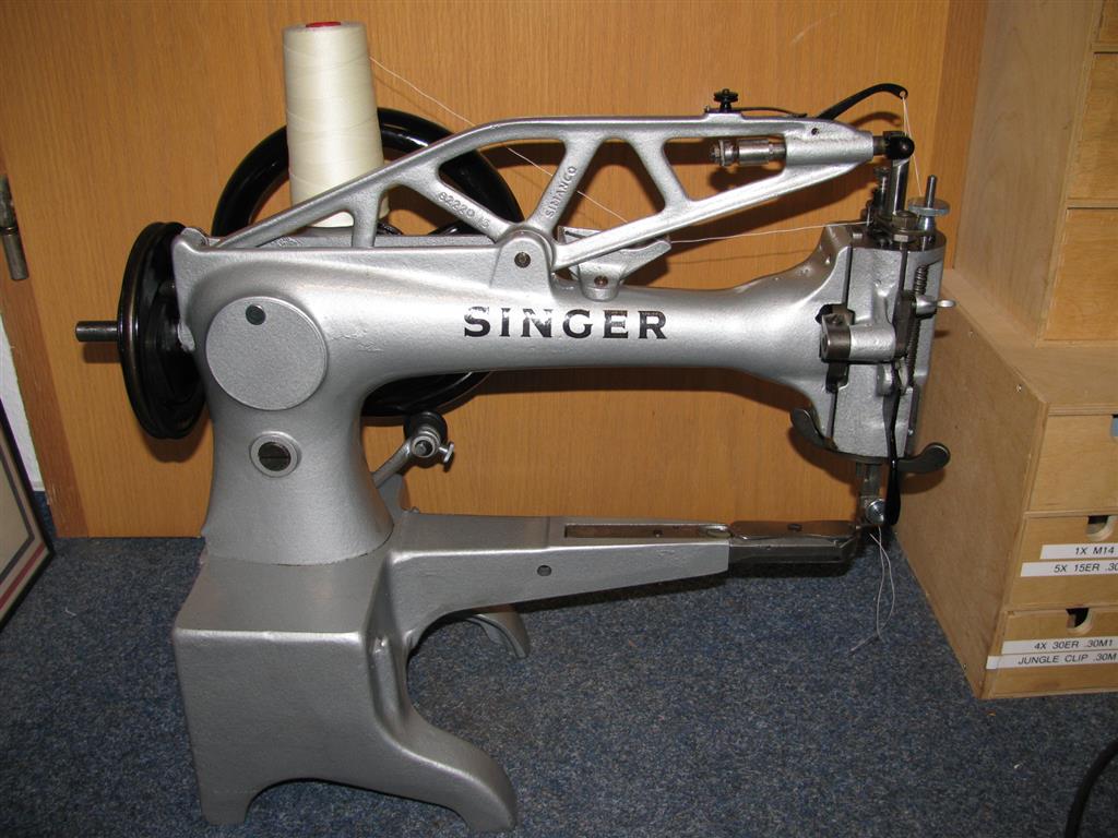

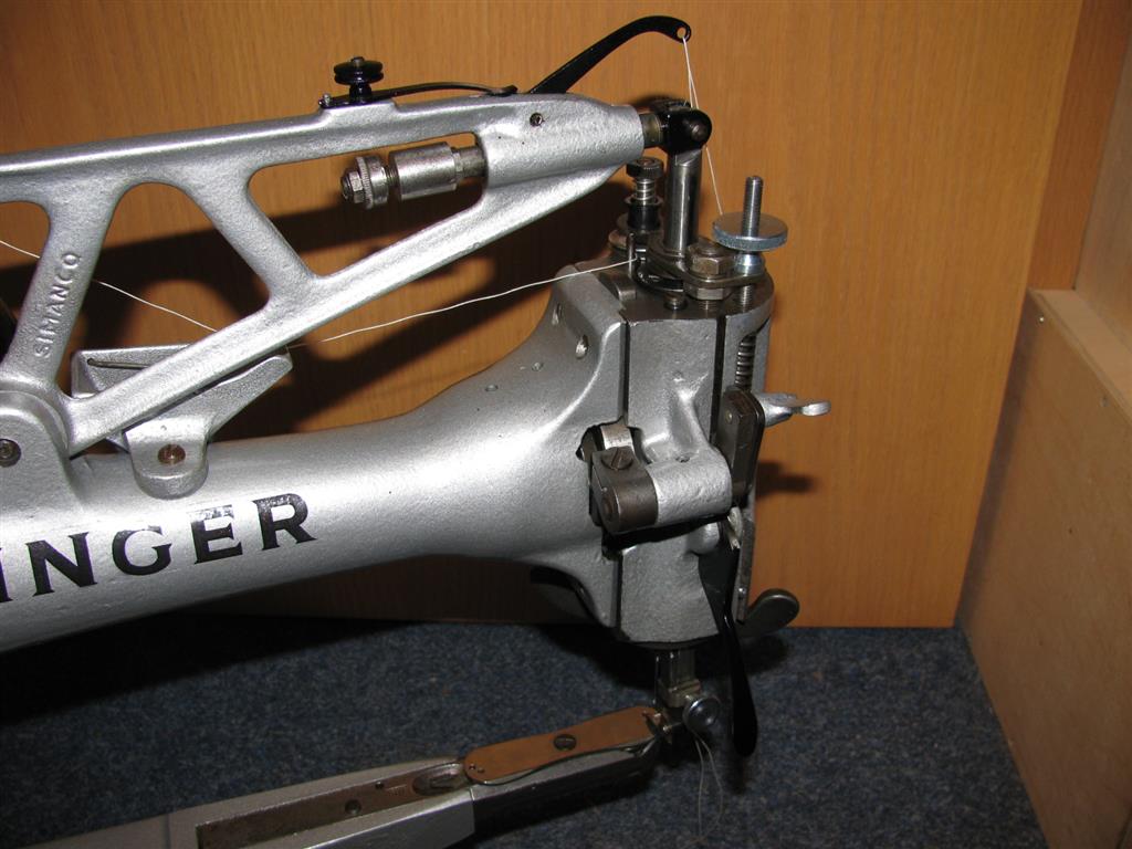

I ordered all parts from College Sewing, UK. Allparts are great - I have no complaints. Only part that "looked" cheap was the bobbing winder but I took the arm of the original Singer bobbin winder and installed the parts from the new bobbin winder - fits perfect and runs perfect. So I´m good with it.
The needle bar glides smoooooooth in the head and for just 25.00 GBP it is quite cheap and it is complete with all parts. Shuttle carrier is nice too. It has a nice finish.
Some pictures:
