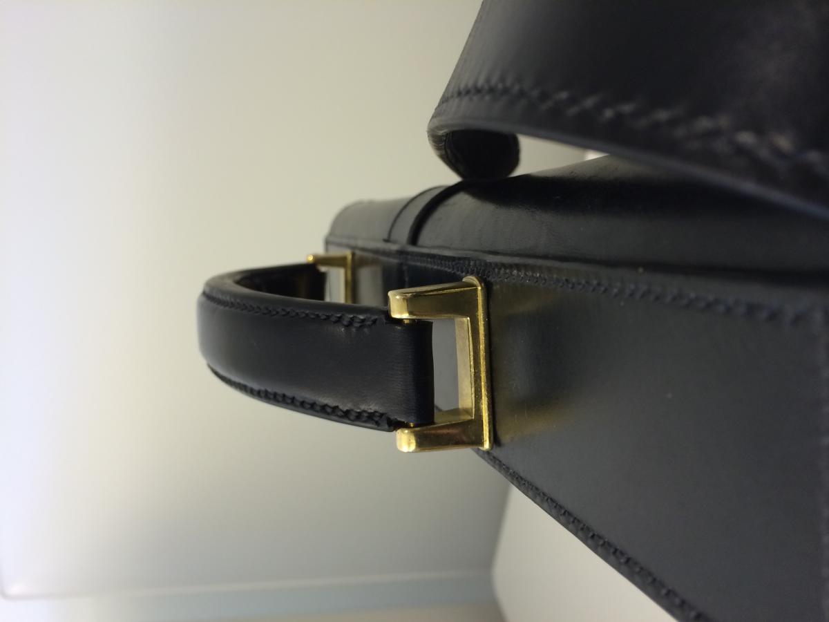

Members malchik Posted June 25, 2014 Members Report Posted June 25, 2014 Mini satchel bag with one main compartment, one back pocket and two front pockets. Shoudler belt in combination bridle / alcantra suede. Made of 2 - 2.4mm Sedgwick english bridle shoulder for the main parts and for curved parts (gusset, flap corners) colored trough (bridle top finish) 2mm belly. Gussets on front pockets made of 1mm goat skin. Hand stitched with 0.8mm braided polyester thread (aka Tiger thread) Quote KAMILeather@Facebook
Members ConradPark Posted June 25, 2014 Members Report Posted June 25, 2014 Lovely work! If you don't mind me asking, are the edges burnished and dyed or have you used any edge coating of any kind? Also the Sedgwick Bridle, does it come already polished or does it have the white wax on the surface from the start? Cheers. Quote

Members malchik Posted June 25, 2014 Author Members Report Posted June 25, 2014 Lovely work! If you don't mind me asking, are the edges burnished and dyed or have you used any edge coating of any kind? Also the Sedgwick Bridle, does it come already polished or does it have the white wax on the surface from the start? Cheers. Edges are both burnished and applied edge coat afterwards. Burnished with saddlers soap, sanded lightly, and two coat of Fenice (Tandy) edge ink (section lacquer) with heat polishing between coats. Sedgwick bridle, it's an art of the leather, beautiful to work with (still didn't found how to bend it without damaging top coat). It comes with white stuff both on top and bottom - works like tallow not wax. When you remove it (with a help of elbow grease ) beautiful bridle finish pops up! Find difficult to cut precisely it with tallow on a top, but was afraid to place ruler on unprotected leather. Pretty stiff, had to sharpen knife couple of times before I was finished cutting. With other words, gives a lot - requires a lot Really really nice work! Thank you Joe, personally I'm not satisfied with all details, but customer was overjoyed Not bad for beginner Quote KAMILeather@Facebook
Members ConradPark Posted June 25, 2014 Members Report Posted June 25, 2014 Hey, thanks for answers and sharing! Just a follow up question regarding the edge ink, I've been using tandy's edge ink as well - mostly on chrome leather - how come that you heat polish it? documentation says to just let it air dry. What I'm wondering is what's the benefit? Sorry for all the questions! And to regards your modesty I have to point out that many sellers don't even come close to your quality of work. Quote
Members malchik Posted June 25, 2014 Author Members Report Posted June 25, 2014 Thank you Conrad Well, what I'm referring to is professional edge ink (it seems Tandy sell no longer - only edge dressing now) which comes from Fenice, Italy. Yes, Tandy says let it dry, but on Fenice web-side states the heat can be applied for increased adherence. The main reason I'm applying the heat after first pass is to smooth fibers (what's left after un-smooth after burnishing and sanding) and making it ready for flawless polishing after pass 2. The effect of this procedure is finished cut edge binding a'la Hermés There's nothing wrong with traditional burnishing/dying/waxing the edges, but what I do gives me more durable edge with not so much more effort than traditional approach. On bags like one on pictures it is essential having as durable edges as possible. After all I'm giving lifetime guaranty Quote KAMILeather@Facebook
