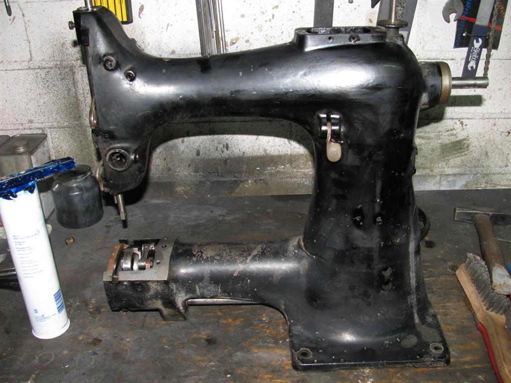

Members Constabulary Posted August 28, 2014 Author Members Report Posted August 28, 2014 (edited) Last weekend was a good "sewing machine weekend", I picked up two machines and one was a Singer 133k3. It is not a walking for machine but this heavy baby will save me a lot of space as I can mount it to the end of my table (had this idea anyway). It has a 12-13mm foot lift which is enough for my work. So my recently restored Adler III has to go again. Regarding the serial # it was built in 1933. It took at least 4hrs to remove all the dust + oil clumps and old hardened grease plaque from in and outside. One good thing is that I can use the presser feet of the Singer 45K / Adler 104 which I still have floating around here. Only thing I have to replace is the check spring and the leave spring for the hook retainer (ordered already). One of the former owners "bubba repaired" the check spring with a piece of heavy brass wire - but it works. :D I had to adjust the hook drive shaft a little bit but that was no big deal. I have cleaned out the two gearboxes and filled with new grease and now it all runs smooth (hand cranked yet). Some pics from the advertising (pics do not tell how dirty it was on the inside), from cleaning and how it currently looks I should take taken some more but forgot to... Edited August 28, 2014 by Constabulary Quote

Members cdthayer Posted August 28, 2014 Members Report Posted August 28, 2014 Interesting old iron, and your clean-up looks good. In the parts manual, it says the Singer 133K3 is “Cylinder Bed, Drop Feed, Roller Presser, Needle Bar Link, Link Take-up, for Leather Work”.What does “Needle Bar Link” and “Link Take-up” mean?CD in Oklahoma Quote
CowboyBob Posted August 28, 2014 Report Posted August 28, 2014 I think the word "link" is just used as a sales pitch they are referring to the fact that there is a link on the needlebar & takeup lever used to run these parts,just like the 31-15 has along with a lot of other machines have. Quote
Members Constabulary Posted August 28, 2014 Author Members Report Posted August 28, 2014 (edited) The thread take up lever has an "extra" link and its movement looks somehow smoother when it is going up and down - sound stupid but that how it looks. It also has an extra guidance below the excenter. @ CD Yeah - once again old cast iron I of course have painted the machine and now I have to orderer some new decals. I just want it to look better than when I have found them. I just have checked ISMCS serial numbers list and the machine was actually made in 1932 (not 133), at that date they made 200 133K and mine was the 2nd in that lot Y8465194 Y- 8465193 - 8465392 133K 200 January 6 1932 I know manuals for the 133K are harder to find but parts lists are not. I have a manuals for the 132K but not for my 133K3 so maybe some one can help me finding a manual. Some may be interested in the manuals for the 132K (one is for 132B26) so here they are: Singer 132B26 Operators Guide.pdf Singer 132K Manual.pdf Edited August 28, 2014 by Constabulary Quote

Members Constabulary Posted September 1, 2014 Author Members Report Posted September 1, 2014 (edited) The paint is ordinary glos black spray paint and even one of the cheapest I have found. But the paint is made by a well know paint company (Kwasny.com) but this paint is more or less a private label brand so it is good quality for a low price . I paid 8€ + shipping for 3 spray cans: www.ebay.de/itm/190438439289 It is extremy fast drying and covers very nice. I like the 133K very much - nice large bobbing and rotary hook. Too bad it has no reverse but for the thick webbing It will work (hopefully). I´m also tinking of buying the flat bad type 132K if one crosses my way for a good price. It´s stupid as I don´t need it but I just like these machiens. Edited September 1, 2014 by Constabulary Quote
