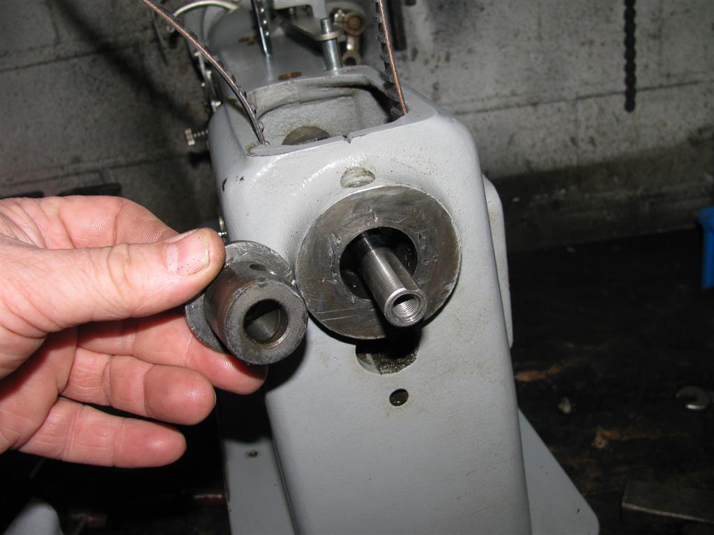

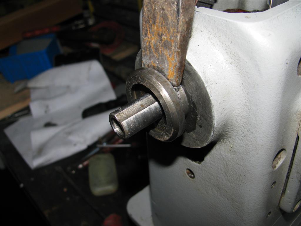

Members Constabulary Posted September 1, 2014 Author Members Report Posted September 1, 2014 okay now here are some pictures. I have not taken pictures of every step - sorry! At first I used a sharp chisel for wood and tapped around the bearing, followed by a big flat head screwdriver, then I have used a more solid chisel and used it s a lever and finally I used a gear puller when the gap between housing an bearing was wide enough. Voila - the bearing is pulled! I squeezed the timing belt through the gap between the upper shaft and housing - this was very very tight and I´m glad I have not damaged the belt! The Adler 167 has a much smaller bearing than the Singer 111 type machines. I used a splint driver to squeeze it through. Then I have cleaned the bearing with fine sandpaper, degreased it and applied some Loctite 601and pushed the bearing back in. For sure not the most elegant way but still better than pulling the entire shaft. I think the "Adler way" is pulling the shaft but removing the pulley is much faster. It took me about 25 minutes to get it out and to replace the belt. Now I have to go ahead and try to time everything (it already was out of time before I replaced the belt) and see what else is going on with this machine. I will for sure have a lot more questions later... Quote ~ Keep "OLD CAST IRON" alive - it´s worth it ~ Machines in use: - Singer 111G156 - Singer 307G2 - Singer 29K71 - Singer 212G141 - Singer 45D91 - Singer 132K6 - Singer 108W20 - Singer 51WSV2 - Singer 143W2
