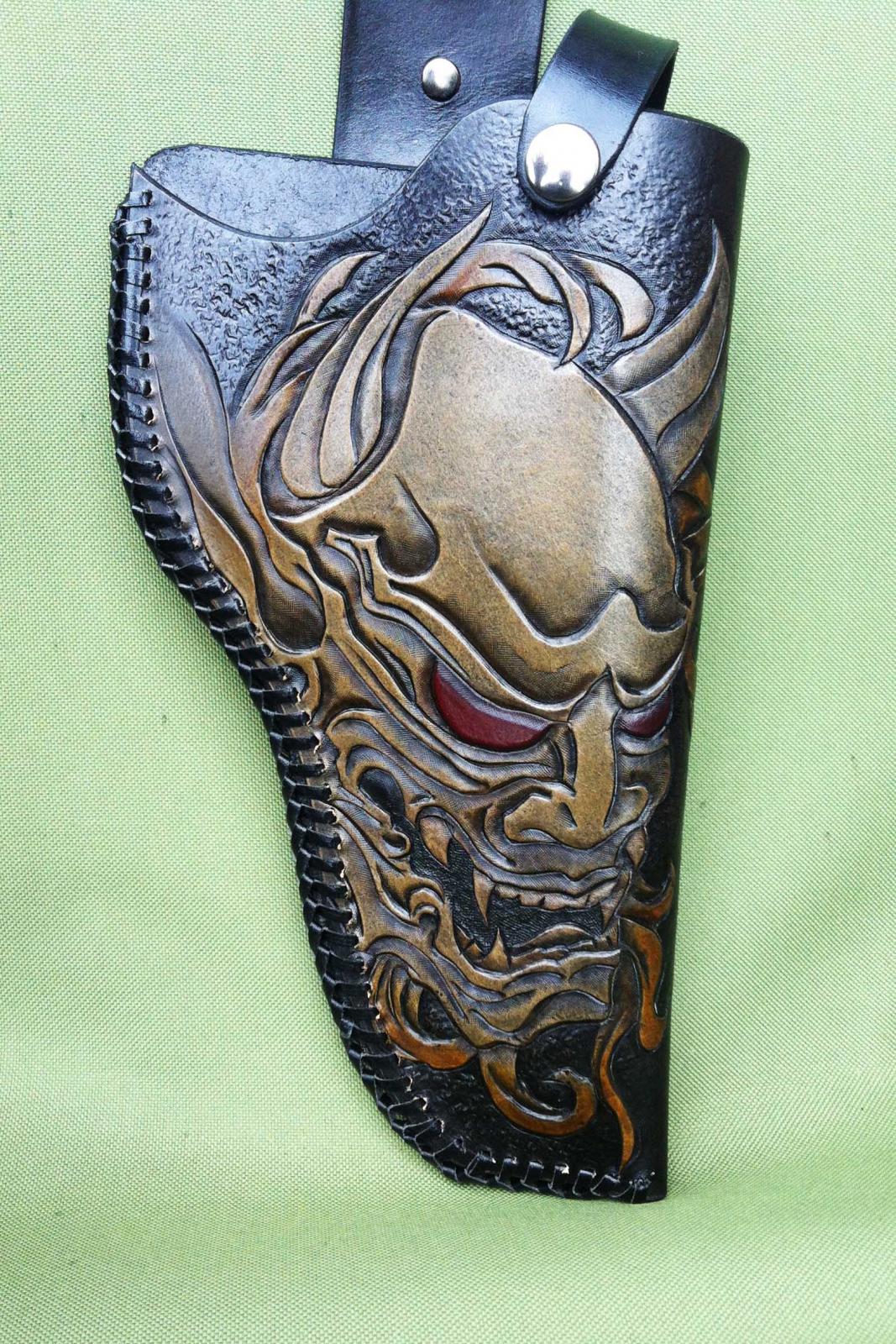

Members Twisted 66 Posted September 2, 2014 Members Report Posted September 2, 2014 All comments, critiques and input welcome. Quote
Contributing Member JLSleather Posted September 2, 2014 Contributing Member Report Posted September 2, 2014 What gun does that suit? I'm wondering about the placement of the snap on your safety strap.. looks like it might go ta banging the cylinder takin the gun inan out (?). Oh, did you punch lacin' holes from the back side? Looks like maybe yer punch was blowin' out a bit. Quote
Members Twisted 66 Posted September 2, 2014 Author Members Report Posted September 2, 2014 the holster is for a.44 magnum ( hence the title ) lol ..the strap sits right across the hammer nicely actually. The lacing was a bitch lol I'll admit it..I couldn't punch through properly so I ended up using a drill. some of the debris around the holes is just dust and pieces..it's been wiped down since then. when you say blown out what exactlly do you mean..the "raised" kinda look by the holes? Quote
Members builderofstuff Posted September 2, 2014 Members Report Posted September 2, 2014 Very cool design my man. I really dig it, and the carving. I like seeing people tooling more tattoo-like designs on their work. Excellent. Chris Quote
Contributing Member JLSleather Posted September 2, 2014 Contributing Member Report Posted September 2, 2014 .44 Mag covers a good bit of ground... S/W 29 / 629 (half a dozen styles) Colt Anaconda Ruger Blackhawk (and Redhawk) Quote
Members camano ridge Posted September 2, 2014 Members Report Posted September 2, 2014 I think what JLS is getting at is not that your strap won't work but since your holster is unlined it looks like the base of the snap is exposed on the inside of the holster and will probably rub against the cylinder of the revolver as you draw out and reholster. This will damage your finish, even on stainless it will probably leave a wear mark, unless you have a plastic snap cover on it. Quote
Members Astinos418 Posted September 2, 2014 Members Report Posted September 2, 2014 Was it hard to get the sizing right for the Magnum? Quote
Members Colt W Knight Posted September 2, 2014 Members Report Posted September 2, 2014 (edited) I would like to see a pistol stuffed down into that holster. I like the tooling, but the holster looks small for a big magnum revolver. I wouldn't want those rivets riding against any of my wheel guns. Edited September 2, 2014 by Colt W Knight Quote

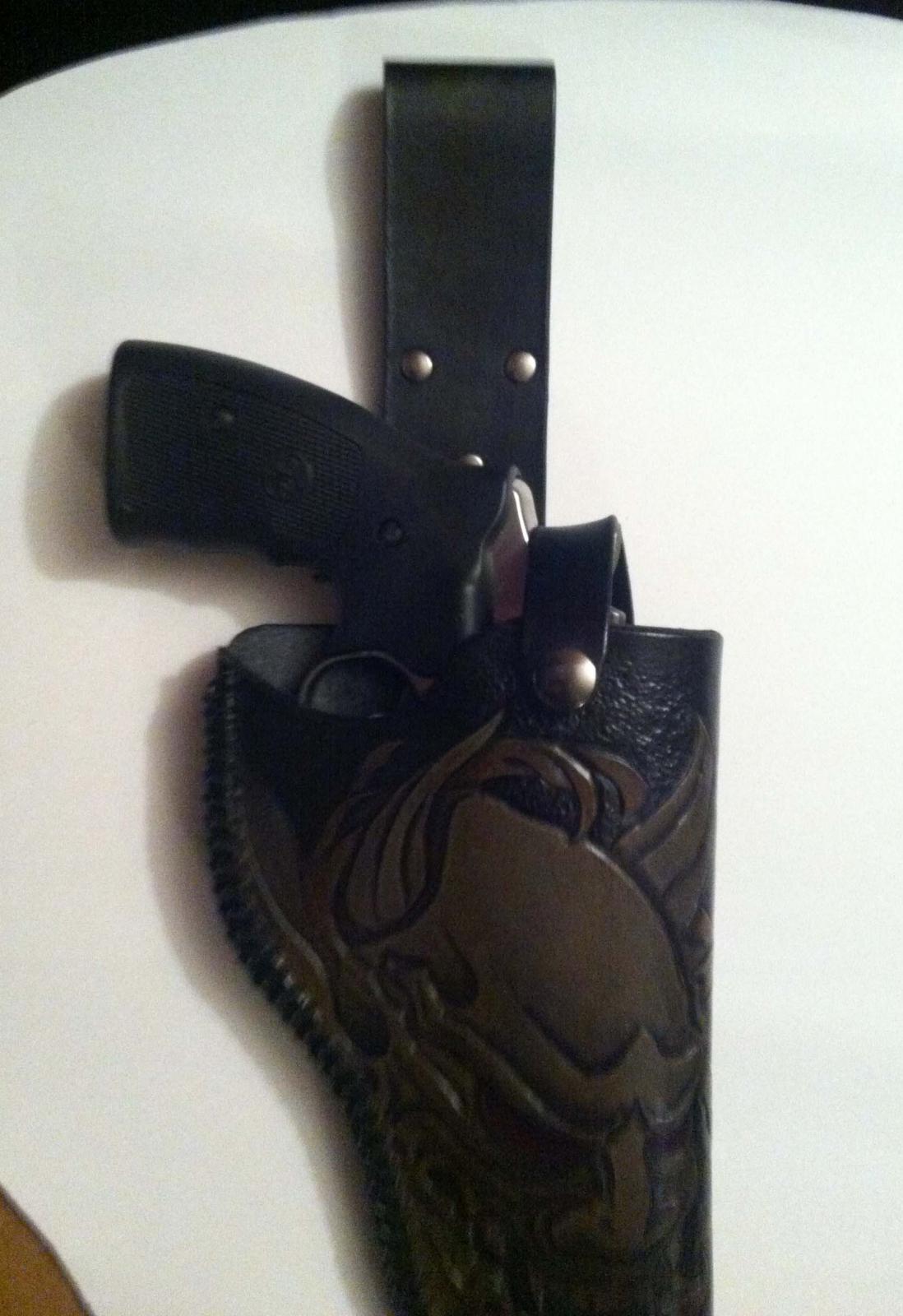

Members Twisted 66 Posted September 3, 2014 Author Members Report Posted September 3, 2014 ok so as a newbie it seems I didn't include as much information as I thought..the gun is a smith and Wesson .44, the inside rivet has been covered by a small piece of leather and no metal touched the gun at all in any way, the sizing took a few times but after playing with a few mock ups I got it to where I wanted it. as for lining it hmm never though about that..what do people line a holster with? suede? material? leather? always open for options/idea/knowledge! again I sit in my newbie corner with that blank expression..lol ( pictures of the piece in the holster coming soon but I'm not sure how to add a pic on here once I've already started the initial thread..hmmmm Quote
Members Twisted 66 Posted September 3, 2014 Author Members Report Posted September 3, 2014 pics of the .44 in the holster Quote
Members camano ridge Posted September 3, 2014 Members Report Posted September 3, 2014 Twisted, I do not like using suede for a liner some people do. I prefer to glu two pieces of the same thickness of leather or the liner slightly thinner. For instance two piece of 4-5 oz glued fuzzy side to fuzzy side, this gives you a holster with the smooth side inside and outside the holster. It also gives you a stiffer holster. You can also sandwich the snap bases etc inbetween the two layers. Quote
Members grumpyold Posted January 18, 2015 Members Report Posted January 18, 2015 How does the gun hang? Belt loop looks narrow for a gun of that weight. Tooling looks great. Quote
Members Twisted 66 Posted January 22, 2015 Author Members Report Posted January 22, 2015 Gun hangs great..spoke with the client the other day and he says he loves it. no issues. Quote
