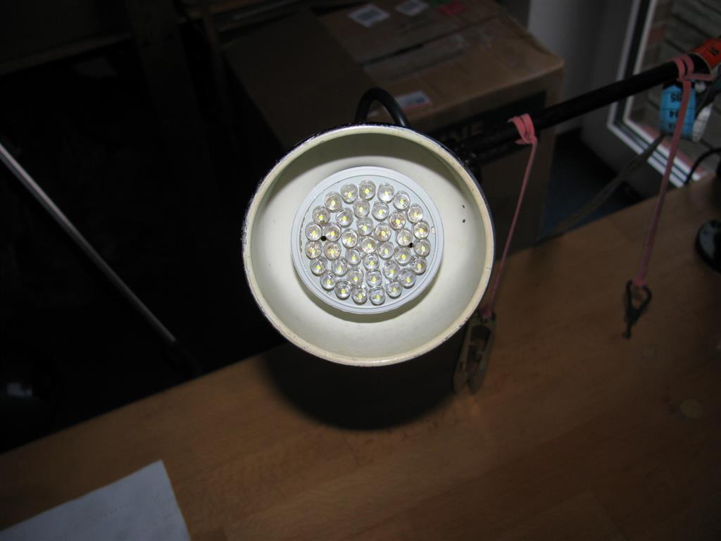

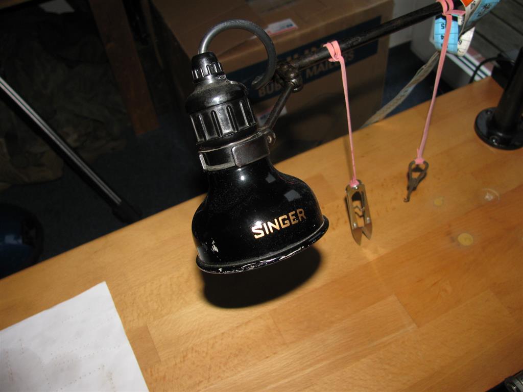

I think 60W is too much when you work close to it. Regularly you find 15W to 25W bulbs in the sewing machine lamps.
I recently have updated my vintage Singer lamps with LED "cold white light" bulbs. They make a nice bright light but are not dazzling.
Advantage: nice bright light, low energy consumption and long life and my lamps still look vintage from the outside. ;)
Some pics:

BTW - they are quite cheap I paid 2.50€ for one bulb. Mine has 38 LED´s and just 2W

Agree with the LED lights. I need lots of light on my subject when sewing. I have two of these on one of my machines.
Tip: Aim the lights toward the path of the needle on your work.
