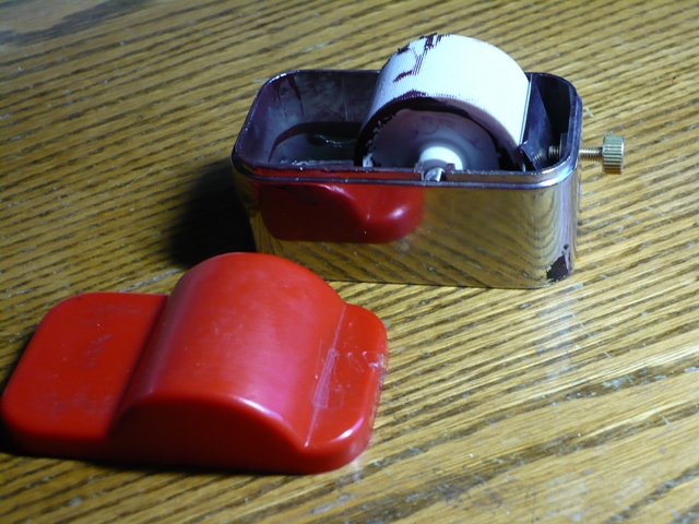

  yaklady said:
I picked up this gadget from Cheylor-Fenneli last spring, like the one that Marlon is talking about. It's just like Celticleather's homemade dealy, only it has a piece that prevents too much edge coat from getting on the roller. That's what the plate against the back of the roller is. It works perfectly! I never would have been smart enough to make my own.
That's it Kathy. That's the exact same thing I have. Do you leave dye in it, or do you clean it after each use?

William, I bought mine at the IFoLG show that was in Ft. Worth in '07. I'm sure if you call them, they can let you know if they still carry it. If I'm not mistaken, I think they have their own edge coat formula.
Marlon
Marlon
I got mine from Keith Johnstone at the show in Wickenburg. They call it an Edge Dyer. They do have their own edge coat formula. It comes in black and brown, and they say it won't crack like Edge Coat will. I don't know what they call it, there is no printing on the bottle whatsoever.
William,
I have an email address for their US agent, Gary Stauffenberg. aussiechill@earthlink.net or phone: 602-264-4225. Gary is in Phoenix. If he doesn't work out, let me know and get you in touch with Keith.
I clean mine out each time. I thnk the roller would get clogged if it wasn't cleaned, then what's the use in having the grooves?
Kathy
