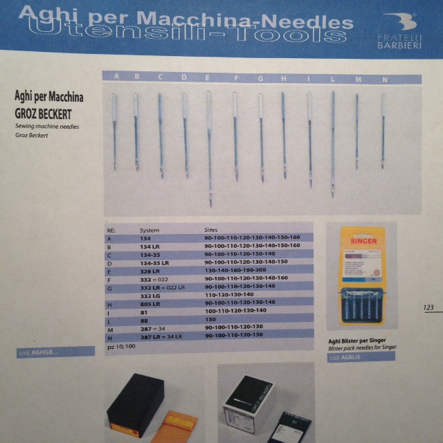

Evo160K Posted November 18, 2014 Author Report Posted November 18, 2014 This G-B needle comparison explained a great deal for me. Quote
