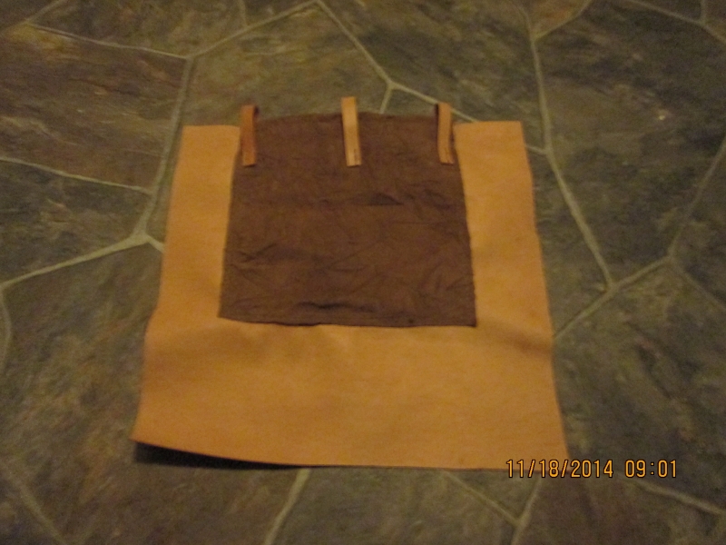

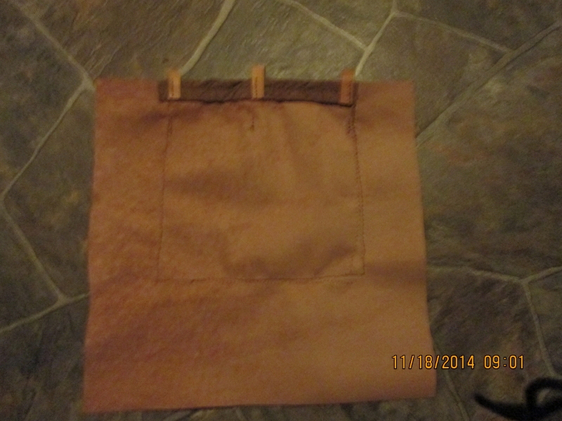

You are most welcome. The problem is I was using (and still am) a 23 needle and 207 thread. Also to sew anything the needle thread and bobbin are supposed to form a knot in the middle. I'm going to show you a pouch I am sewing right now and explain some things I would do over if I was redoing it.
The main pouch is going to be sewn 3 layers of around 1" pig. I put a different color of lamb on the front, also about 1 " , and it will have like a welt at the bottom that is holding the fringe. And I intend to make a dog collar type closure so I'm sewing belt loops on it. To make things worse the pig is stretchy and the lamb isn't. All in all a not very well thought out project but one I wanted to make. I will post the pictures and then explain what's wrong with it and why I wish I had used a smaller machine for it.

If you look at the first pic lranger you'll see the material on the front is sewn pretty well, not perfect by any means. I held the lamb in place with double sided tape. However I sewed it before this picture and you can see in the second picture where I didn't have it taped and the pig stretched all over and the lamb didn't. This is just a prototype, first time I've made a pouch with fringe so I am learning as I go. The pouch will be rounded on the bottom. You can still see here that there's very little room for the thread to knot in the middle. Cheryl
