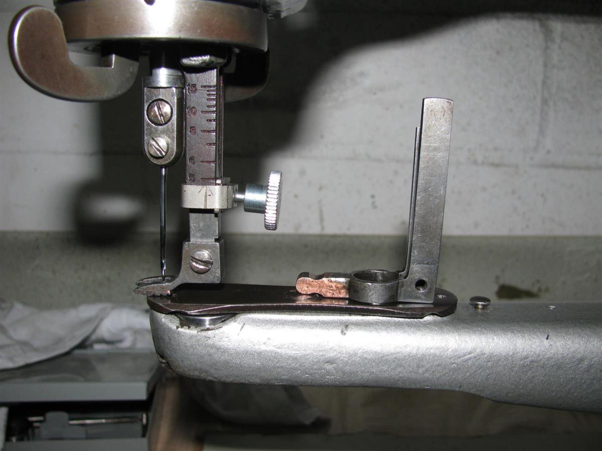

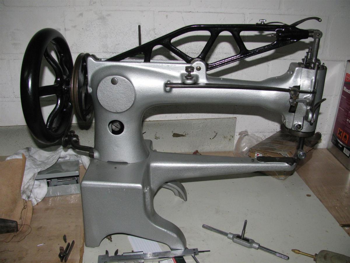

makitmama Posted January 13, 2015 Report Posted January 13, 2015 GOOD NEWS! Today my last order from College Sewing has arrived and I was able to install the BCL. To be continued... so- how about some photos? or a nice short video? that way we can all enjoy it too! Quote
Members Constabulary Posted January 13, 2015 Author Members Report Posted January 13, 2015 here are some quick shots for the impatient ones Quote
Evo160K Posted January 13, 2015 Report Posted January 13, 2015 Constabulary, Looks fine to me. Thank you for the blow-by-blow details of the restoration, they're very helpful. I noticed the thread tap in the second picture, do you have a set of "Singer" taps? Quote

Members Constabulary Posted January 14, 2015 Author Members Report Posted January 14, 2015 (edited) Al - No it is metric. I had to tap a new thread for the thumb screw as it came with a metric thread. Darren - they are commercial availlable? Sounds good - can you point me to a tap set for Singer threads? I live in a metric World and do not know much about the US threading system but a Singer tap set would be nice to have. Edited January 14, 2015 by Constabulary Quote

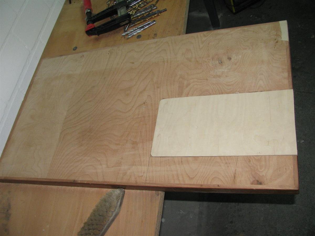

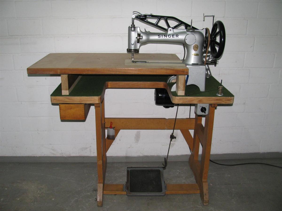

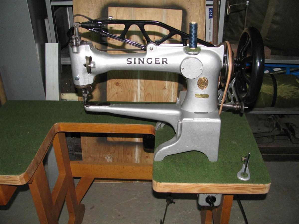

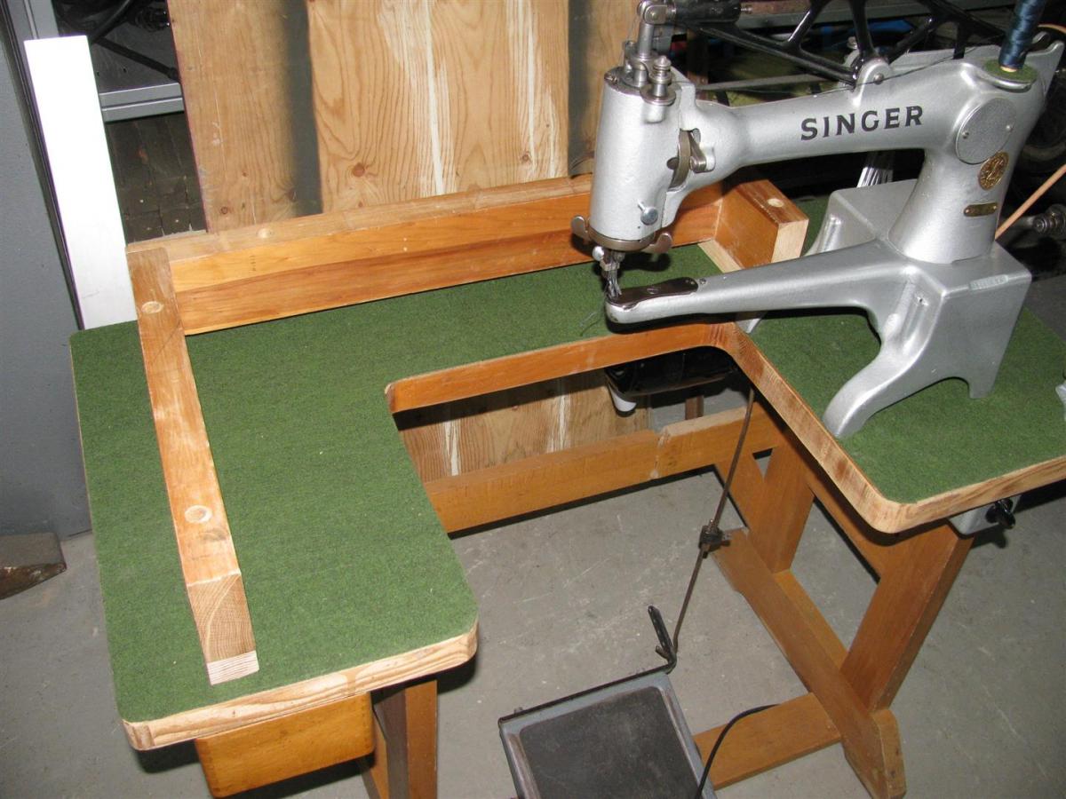

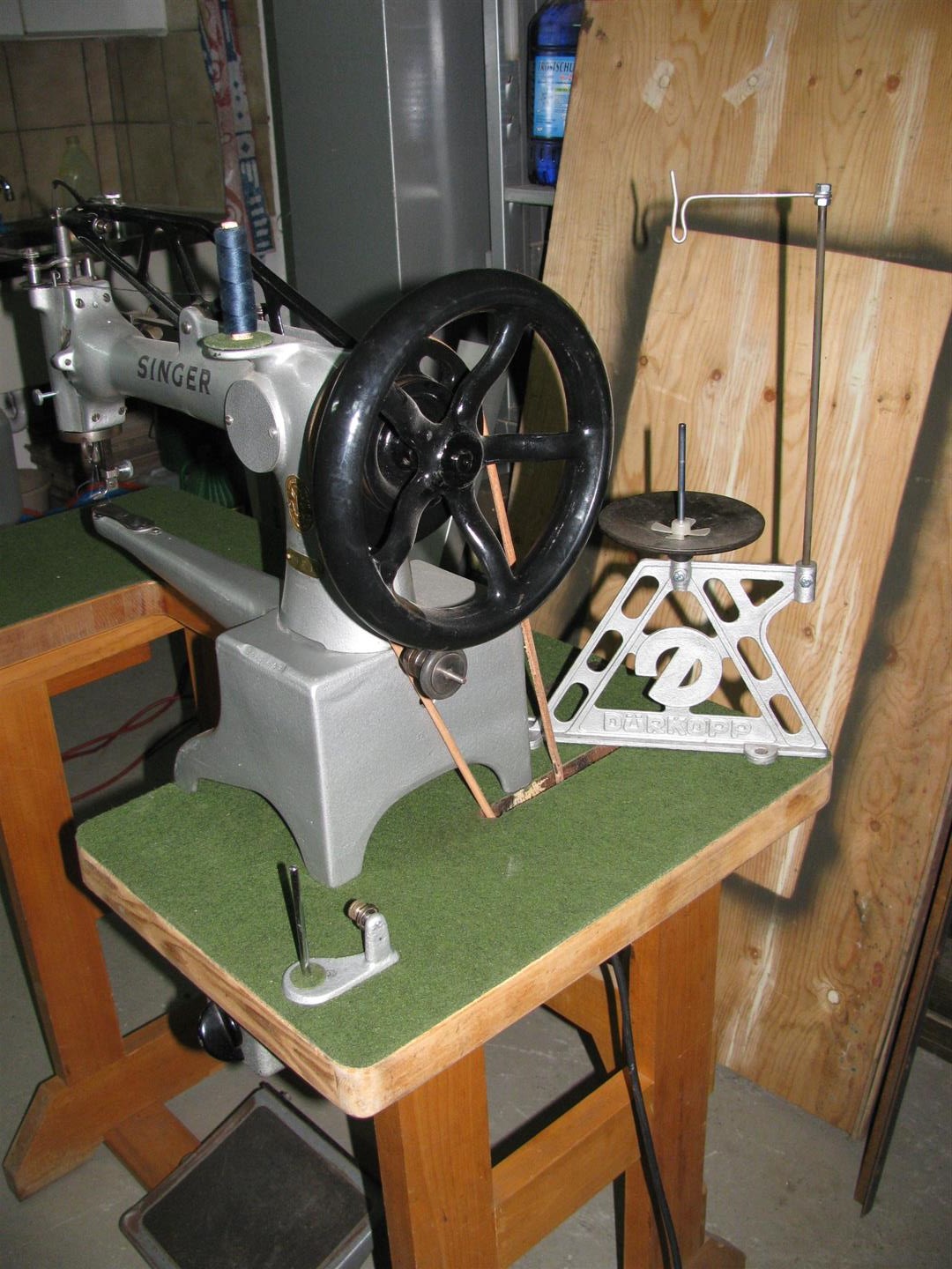

Members Constabulary Posted January 22, 2015 Author Members Report Posted January 22, 2015 Some progress I have added a small speed reducer and a flat bed XL attachment some more pics Quote
Members Constabulary Posted January 22, 2015 Author Members Report Posted January 22, 2015 Tomorrow I´ll work on some small details and will test sew it. Then I´m done I think. I´ll try to make a small video in the days to come. Quote

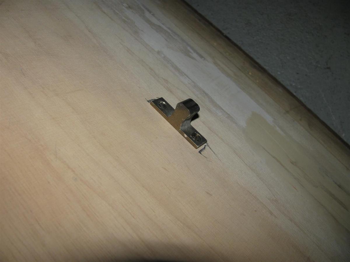

Members Constabulary Posted January 24, 2015 Author Members Report Posted January 24, 2015 (edited) Added some cabinet door snappers (or how do you call them?) to put the flat bed in a fixed position. And I have added a sewing lamp. I´m finally done And here is a Video https://www.youtube.com/watch?v=YFmD-Qfn08g Edited January 24, 2015 by Constabulary Quote
