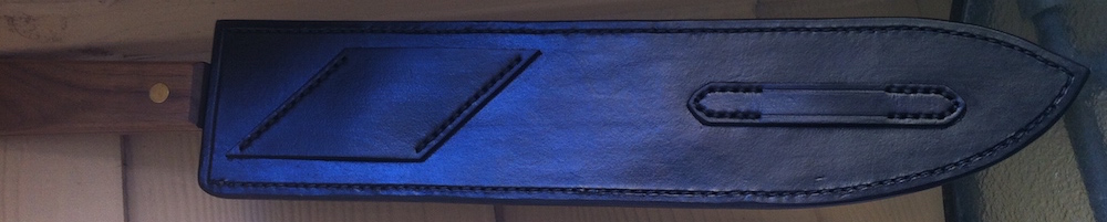

Members thefanninator Posted February 17, 2015 Members Report Posted February 17, 2015 Sheath for a machete. 14" blade, 8/9 oz. Hermann Oak, basketweave, sunburst border, Fiebing's chocolate, dark brown antique, Tan Kote, LCI Clear Lac, Tandy poly braided cord. Anyone make a sheath that hangs at a 45º angle? That's what this guy wanted. I hope it works! Quote http://www.instagram.com/fannintexas/

Members TexasJack Posted February 18, 2015 Members Report Posted February 18, 2015 Nice basketweave! Not crazy about the belt loop. I'd want stronger stitching and more room for the belt. In order for 45 deg. to work on such a long blade, the belt loop needs to be fairly close to the center of mass. Otherwise there will always be a lot of torque on the belt loop. This would be a good application for a frog. Quote
Members thefanninator Posted February 18, 2015 Author Members Report Posted February 18, 2015 Nice basketweave! Not crazy about the belt loop. I'd want stronger stitching and more room for the belt. In order for 45 deg. to work on such a long blade, the belt loop needs to be fairly close to the center of mass. Otherwise there will always be a lot of torque on the belt loop. This would be a good application for a frog. Thanks for all the compliments guys! What makes you think the stitching isn't strong? The belt loop is the angled, wider one on the left. The loop on the right is for "lashing it to a pack" or something like that. Yeah, I may have to move the belt loop closer to the center. I tried it on a belt tonight and kinda discovered this. I have no idea what you mean by "This would be a good application for a frog." Quote http://www.instagram.com/fannintexas/
Members TexasJack Posted February 18, 2015 Members Report Posted February 18, 2015 I would have made a loop of stitches - like a "D" on it's side. A single line of stitches will have to take a lot of stress. Also, shape the loop with a piece of leather or strip of wood so it already has the space for a belt and doesn't have to be stretched (i.e., stressed) to fit a belt. I'm no expert, nor do I have any right to claim that I am. I'm just echoing what guys who are experts showed me. A frog is a means of holding a sheath onto a belt that fits externally to the sheath. I did a quick google to try to find what I meant and I see a couple of similar things. Here's one on sale on Amazon: Sword frog Here's another version: LARP Sword Frog Quote
Members thefanninator Posted February 18, 2015 Author Members Report Posted February 18, 2015 I'm no expert either. Haven't made many sheaths. Do you have a pic of the loop of stitches, the "D" on it's side? I'm having a hard time picturing that. The 45º angle gave me some trouble anyway. I couldn't stitch it to the main seam because it wouldn't have been 45º. The frog is pretty cool. Didn't think about that. Although I'm sure I've seen it in a movie. Quote http://www.instagram.com/fannintexas/
Members MonicaJacobson Posted February 18, 2015 Members Report Posted February 18, 2015 Nice, Chris. Someone (maybe Mike?) suggested when I made a knife sheath that I should put an extra layer of leather under the stitching on the back of the pouch. Or you could form it. Or do neither. I've only made one sheath, I'm totally not qualified. Quote http://monicajacobson.com/ https://www.etsy.com/shop/TrimGoTrix?ref=si_shop
Members TexasJack Posted February 18, 2015 Members Report Posted February 18, 2015 Of course, trying to find a picture when you want one is always impossible. Look at the loop on this one: First sheath since... The way you have it sewed - straight across - will put a lot of stress on that thread. A double line - made into a box or a "D" shape will give you more strength and will have some stitches parallel to the loop and thus parallel to the stress. Quote
