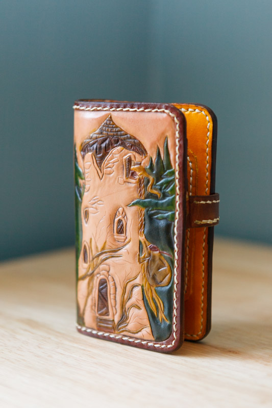

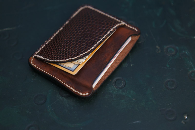

Members MonicaJacobson Posted February 18, 2015 Members Report Posted February 18, 2015 I've been practicing making wallets the last month or so. I bought an 8spi vergez iron in November, and am enjoying getting to use it. Obviously, I used my normal 6 spi on some, but I'm definitely moving towards 8spi for wallets. Just need smaller thread and needles. First to last, minus the dragon wallet I've already posted. LOL, the first one was beyond terrible: These are a little better, I hope. Quote http://monicajacobson.com/ https://www.etsy.com/shop/TrimGoTrix?ref=si_shop
Members plowboy73 Posted February 18, 2015 Members Report Posted February 18, 2015 Ok i am blown away by the coolness of your tooled ones. Looks great to me! Quote
Members capsterdog Posted February 19, 2015 Members Report Posted February 19, 2015 They all look wonderful. I am still testing my wallet theories, I hope they look as good. Quote
Members texback Posted February 19, 2015 Members Report Posted February 19, 2015 That's some pretty nice wallets you have there/ Quote

Members MonicaJacobson Posted February 19, 2015 Author Members Report Posted February 19, 2015 Oh yes, I love it. That's what I used on all of these. The problem is, even the .6mm isn't thin enough on a single layer. On the lizard skin one, you can see it looks too big along the top where I sewed the lizard skin to the pigskin. Joe recommended Royalwood linens, but I need to chase them down by phone as they haven't answered my e-mail. Of course, the other alternative is Au Chinois, but it's $48.00 + shipping for only 820 feet! Crazy. I did find out you can get waxed Tiger thread in .4mm from Abbey England (at $64.00 + shipping) for 1000 meters. But only in "mid brown" and black. I was hoping to find cream. Quote http://monicajacobson.com/ https://www.etsy.com/shop/TrimGoTrix?ref=si_shop

Members Hi Im Joe Posted February 20, 2015 Members Report Posted February 20, 2015 On 2/19/2015 at 2:17 PM, MonicaJacobson said: 25B -ha, I thought you'd feel justified. Now you just need to convert Joe. kwelna, - the 6spi is the chisel and the 8spi is the pricking iron. You're right, there's definitely a difference, and it's not just the size. Guess I need to save up for the whole collection. Not gonna happen. I tried it a couple times and to me the stitch is even less consistent from side to side. Maybe its the way I pass the needles through but for me I've gotten the best most consistent stitching from using Valerie Michael's method from her book. For me too I hate pricking two pieces and then trying to line everything up. Quote http://www.sevenhillsleather.com/
Members MonicaJacobson Posted February 20, 2015 Author Members Report Posted February 20, 2015 Well, I must admit that the stitching isn't always correct.. you can see an inconsistency or two in the way the stitch lays in the croc print one. Are you going all the way through with the chisel? Or going part-way through and finishing with an awl? Once I get an awl blade thin enough for 8spi, I might end up doing that as well. It's about half as much work if your awl is sharp and you have a groove or mark to guide your stitching line. Quote http://monicajacobson.com/ https://www.etsy.com/shop/TrimGoTrix?ref=si_shop
