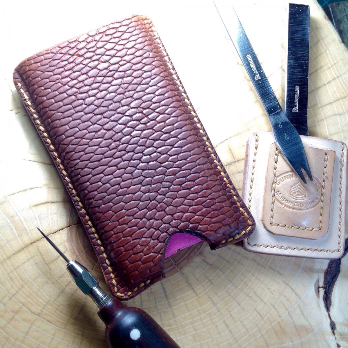

Members Hi Im Joe Posted February 20, 2015 Members Report Posted February 20, 2015 25B -ha, I thought you'd feel justified. Now you just need to convert Joe. kwelna, - the 6spi is the chisel and the 8spi is the pricking iron. You're right, there's definitely a difference, and it's not just the size. Guess I need to save up for the whole collection. Not gonna happen. I tried it a couple times and to me the stitch is even less consistent from side to side. Maybe its the way I pass the needles through but for me I've gotten the best most consistent stitching from using Valerie Michael's method from her book. For me too I hate pricking two pieces and then trying to line everything up. Quote http://www.sevenhillsleather.com/
Members MonicaJacobson Posted February 20, 2015 Author Members Report Posted February 20, 2015 Well, I must admit that the stitching isn't always correct.. you can see an inconsistency or two in the way the stitch lays in the croc print one. Are you going all the way through with the chisel? Or going part-way through and finishing with an awl? Once I get an awl blade thin enough for 8spi, I might end up doing that as well. It's about half as much work if your awl is sharp and you have a groove or mark to guide your stitching line. Quote http://monicajacobson.com/ https://www.etsy.com/shop/TrimGoTrix?ref=si_shop
