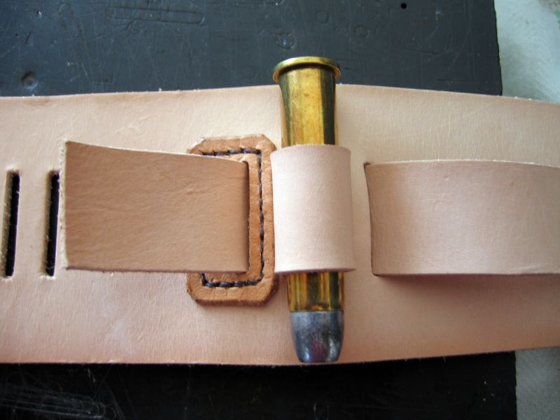

Members Hedge Posted November 18, 2008 Members Report Posted November 18, 2008 Had a bounce on my slot cutter. Anyone have a way to clean up this cut before I scrap all the work and start over? Wouldn't be so bad but it's going to be on an exposed portion. Hedge Quote
stelmackr Posted November 18, 2008 Report Posted November 18, 2008 Had a bounce on my slot cutter. Anyone have a way to clean up this cut before I scrap all the work and start over? Wouldn't be so bad but it's going to be on an exposed portion.Hedge Punch one more slot so the bullet is over the error when the leather is woven in. Bob Stelmack Quote Bob Stelmack Desert Leathercraft LLC Former Editor of the, RawHide Gazette, for the Puget Sound Leather Artisans Co-Op, 25 years of doing it was enough...
Contributing Member TwinOaks Posted November 18, 2008 Contributing Member Report Posted November 18, 2008 Good idea, Bob. Hopefully there's enough room for that. I've been playing with the idea of pulling a loop through the slot instead of weaving through them...maybe this would be a good place to try that? Other than that....run a stamp between the loops and make it more decorative. That should allow you to hide the bounce pretty well. Quote Mike DeLoach Esse Quam Videri (Be rather than Seem) "Don't learn the tricks of the trade.....Learn the trade." "Teach what you know......Learn what you don't." LEATHER ARTISAN'S DIGITAL GUILD on Facebook.
TomSwede Posted November 18, 2008 Report Posted November 18, 2008 I thought about wrapping the leather between the holes with lace. Maybe it could be done in a decorative way?? Just gotta check if theres is enough clearance for the connecting strap otherwise one could file up the holes a bit. Tom Quote Confucius - Better a diamond with a flaw than a pebble without. --------------------------------------------- www.1eye1.se blogg.1eye1.se
Contributing Member Jordan Posted November 18, 2008 Contributing Member Report Posted November 18, 2008 (edited) If the bullet is big enough and the strap is thick enough they may cover most of it. then use a slicker to disguise the rest of the error. Or use a stamp like barbed wire around the edges of each slot. Start the strap from the back side of the 1st slot and feed it back through each slot so the loop is formed at each slot instead of every other one. Edited November 18, 2008 by Jordan Quote
rickybobby Posted November 18, 2008 Report Posted November 18, 2008 Had a bounce on my slot cutter. Anyone have a way to clean up this cut before I scrap all the work and start over? Wouldn't be so bad but it's going to be on an exposed portion.Hedge I just finished a gunbelt like this and I tried the meathod that Mike and Jordan suggested, "run the lope in the same hole" I is very "clean" looking and the shells are so close together it looks very professional. I am never looking back at sewing loops again! Well look at it this way, Ya got one to try it on!! Hope this helps, Rick Jorgenson Quote Rick
Members Hedge Posted November 18, 2008 Author Members Report Posted November 18, 2008 Punch one more slot so the bullet is over the error when the leather is woven in.Bob Stelmack Good idea, Bob. Bad thing is that it's at the very end where the loop leather will exit and be laced to the belt. It's on one of my Quigley's, so the design is fixed. Quote
Members Hedge Posted November 18, 2008 Author Members Report Posted November 18, 2008 Good idea, Bob. Hopefully there's enough room for that. I've been playing with the idea of pulling a loop through the slot instead of weaving through them...maybe this would be a good place to try that?Other than that....run a stamp between the loops and make it more decorative. That should allow you to hide the bounce pretty well. Mike, I'll give stamping a try and see how it looks. This was my last piece of quality leather and there's no time to get another. Guess I'm kinda quirky...I'd rather try to hide a mistake rather than waste a fine cut of hide. I've got another piece but it's flanky on the back and I won't send out a flanky backed belt. Quote
Members Hedge Posted November 18, 2008 Author Members Report Posted November 18, 2008 I thought about wrapping the leather between the holes with lace. Maybe it could be done in a decorative way??Just gotta check if theres is enough clearance for the connecting strap otherwise one could file up the holes a bit. Tom Tom, Thanks for the idea. I think I'll try it on another belt. This one, though, won't have the room. Quote

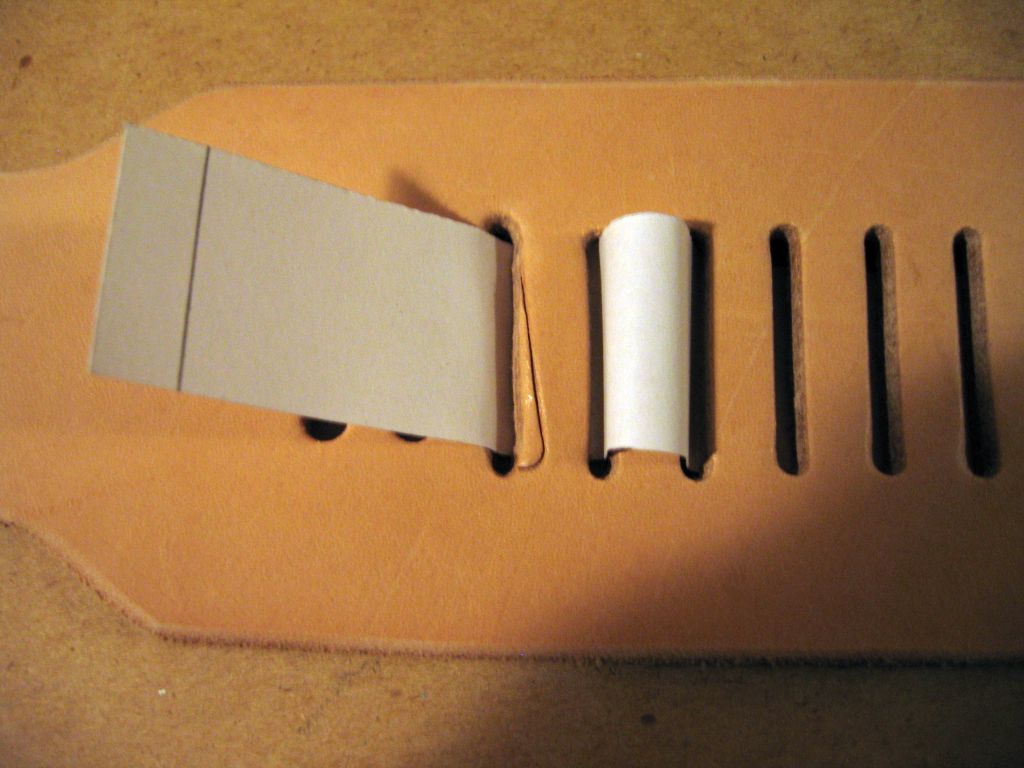

Members Hedge Posted November 18, 2008 Author Members Report Posted November 18, 2008 If the bullet is big enough and the strap is thick enough they may cover most of it. then use a slicker to disguise the rest of the error. Or use a stamp like barbed wire around the edges of each slot. Start the strap from the back side of the 1st slot and feed it back through each slot so the loop is formed at each slot instead of every other one. I like this idea, Jordan. It's definitely something I'll work up on a different style belt. Unfortunately, it won't work on this one. The cut will be on an exposed portion. The paper path shows how the loop leather is supposed to run on this design. Quote
