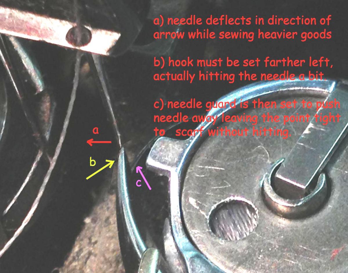

Members venator Posted April 12, 2015 Author Members Report Posted April 12, 2015 I lied turns out I just got lucky a few times and it didn't break, it breaks much more easily on the dyed leather though. I can tell you that the thread breaks right as the upstroke on the needle begins. Quote
Members venator Posted April 12, 2015 Author Members Report Posted April 12, 2015 I don't think you should be putting words in their mouths. Please don't misunderstand, I haven't spoken with them and I'm certainly not in any way attempting to speak poorly of them. I simply don't see what someone who's thousands of miles away can do over the phone that won't cost me an arm and a leg. In my experience the further a seller is from you geographically and particularly different countries the less they're able to support their product. This is not their fault and I don't mean to sound like I'm blaming them as I'm sure that somehow this is something I did (god knows what but it must be). Quote
Members venator Posted April 12, 2015 Author Members Report Posted April 12, 2015 Here's a close up video of the thread breaking, hopefully someone can see if I've done something dumb that's causing it. Video.MOV Quote

Uwe Posted April 13, 2015 Report Posted April 13, 2015 (edited) Your problem may have to do with the needle as well. Your thread appears to "break" right after you reverse. I noticed that when I use leather tri-point needles, the needle will sometimes actually cut the thread in a previously stitched hole if I reverse the stitch. The leather point needle tips are like little knives and they cut leather (and thread) quite easily. Your thread may be cut instead of break when reversing, or the thread may be cut partially and then break when it's pulled tight in the upward stroke. Personally, I no longer use reverse when I stitch thick leather with a tri-point or similar knife-edged needle. I just finish the seam by hand, which is a little more manual work, but to me it looks cleaner and is less frustrating than messing up an otherwise fine seam on the second to last stitch. I'd try sewing with a different needle (regular point, not a knife-edge needle) and see if the thread still breaks upon reversing. If your thread also breaks when stitching forward into new holes, the problem is not the needle. Try to eliminate a few possible causes. Edited April 13, 2015 by Uwe Quote Uwe (pronounced "OOH-vuh" ) Links: Videos
