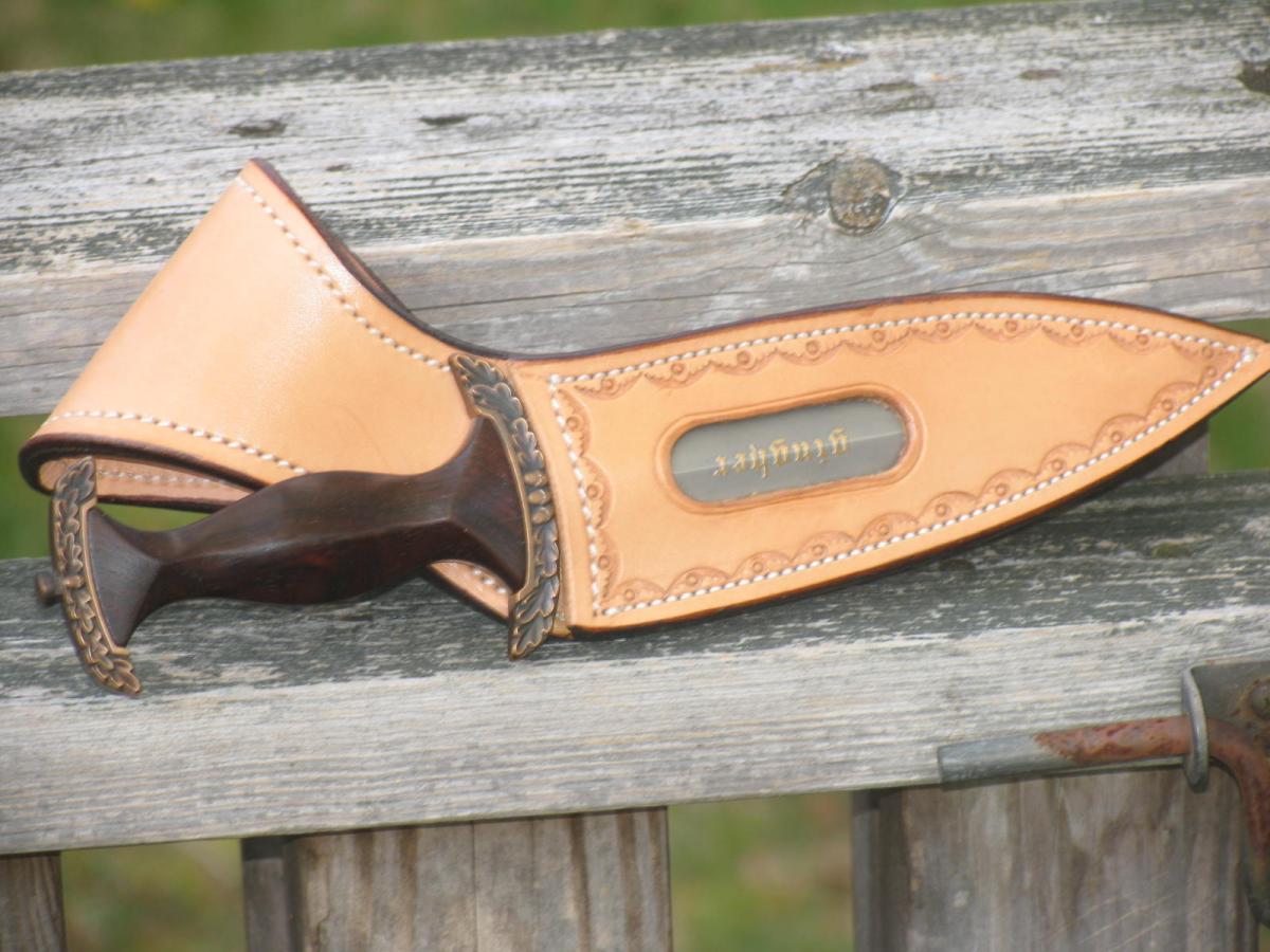

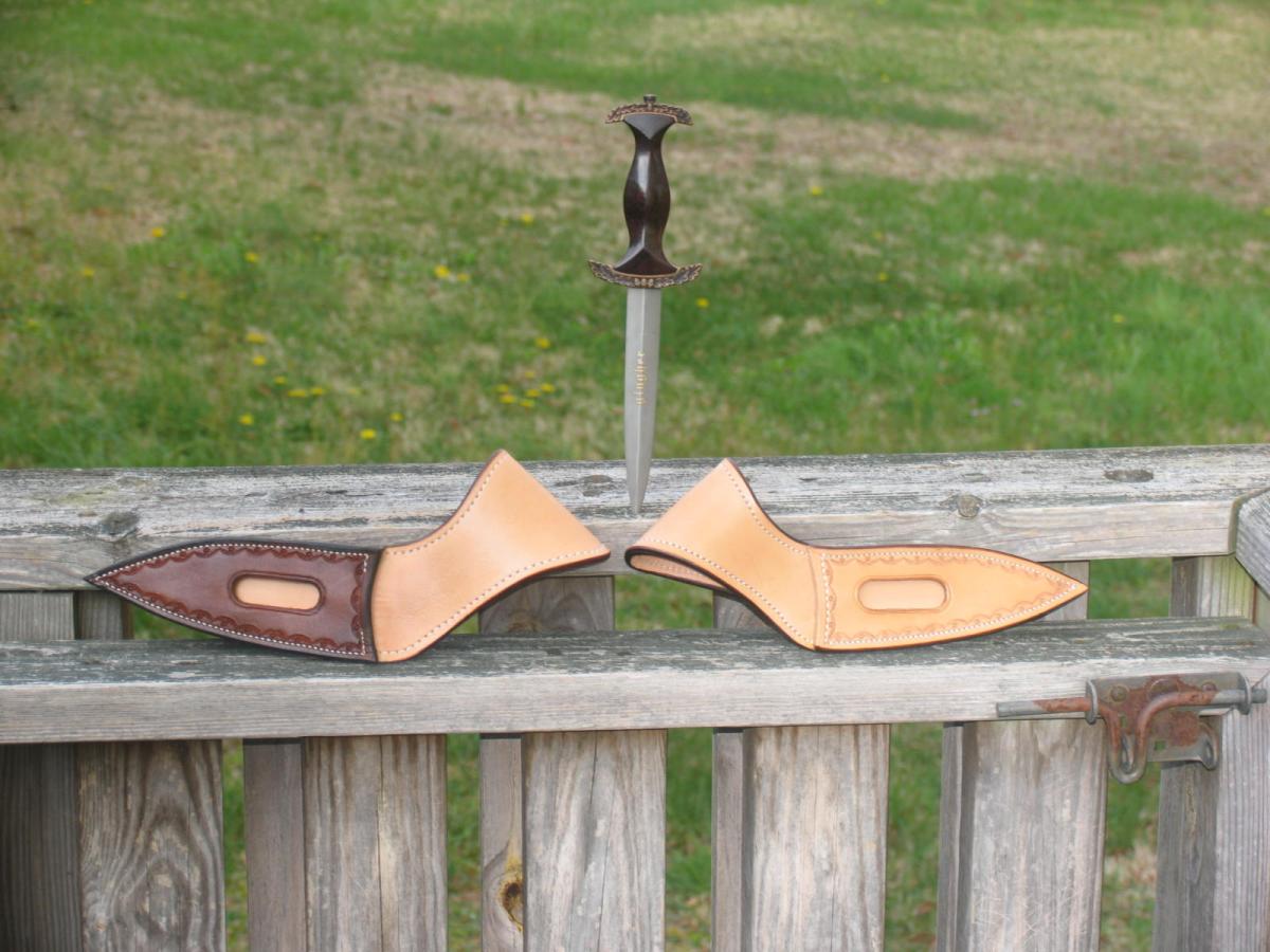

Members Red Cent Posted July 1, 2015 Members Report Posted July 1, 2015 Unique knife. Customer wanted two same style, different color. I try to make all my sheaths with two separate pieces of leather. I taper the welt on the point and on the hidden side of the welt. I am also a little generous with the glue. I slice open the glue when inserting the knife. Won't hurt the knife. The other picture is a cheap blued blade (I like it) knife and sheath. Stays put. I kept the knife and sheath. May I suggest that when you do the folding knife sheath, make the sheath partly open on the bottom that allows the finger guard to be sheathed plus an inch. When you wet mold the leather will collapse behind the finger guard an provide retension. Great retention but rather easy to draw. Quote
Members ChiefFilipino Posted July 1, 2015 Author Members Report Posted July 1, 2015 Those are beautiful Red Cent! When I add that inch behind the finger guard and the leather collapses, won't I be smooshing the leather when I re-sheath the knife? With this one the guard was ramming into the leather and it would collapse together closing off the hole. Quote
