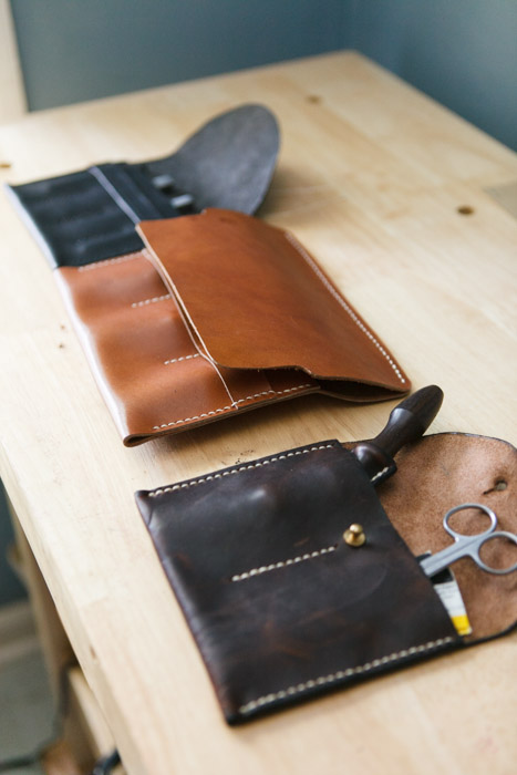

Members MonicaJacobson Posted July 31, 2015 Members Report Posted July 31, 2015 My shop is in my dining room, so I'm forced to put everything away after I use it - no peg board and metal hangers for me. I made a little sheath for my awl, and it, the needles, and scissors all go in one pouch, with all my pricking irons and edge bevelers in another pouch. It's nice to be able to grab the whole pouch. It's also nice to use samples of leather I have laying around and see how they wear over time. Quote
