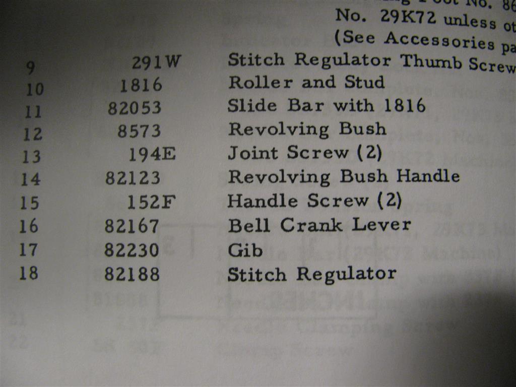

Members Jim607 Posted February 8, 2016 Members Report Posted February 8, 2016 I also am having a problem with my 29K71..The presser foot will not drop down to feed the material and if its pushed down into down position it seems to bind and will not raise to feed the material. I have tried adjusting the height adjustment but no luck. Can someone point me in the right direction for this fix. Quote
Members Constabulary Posted February 8, 2016 Members Report Posted February 8, 2016 Check the stitch length adjuster - maybe the gib is gone or bent or worn and needs to be replaced or is it is placed on the wrong side (in picture 1 it is placed wrong). It´s parts #17 in picture 1. The gib belongs on the end with the thumb screw. The gib also is flattened on one side. The flattened part has to be up and facing towards the presser foot bar. The squared adjuster piece the thumbscrew goes in also has a flattened part and here the flattened parts had to be down. Hope you know what I mean. If this does not help I´d take the head apart and clean it. You never know what kind of dirt the machine has collected over the years. Always good to post some good detailed pictures of your machine so maybe someone sees if there is something wrong. Quote
Members Jim607 Posted February 9, 2016 Members Report Posted February 9, 2016 Constabulary. ..I have tried to post a reply twice so far and it seems they never made. I am about as good with computers and forums as I as m with sewing machines. Any how you are 100% correct on your diagnosis. I am sure that I have it in reversed and will recheck when I get home. It clicked just as I read your explanation. Thanks a ton for uour advise. Jim King and I hope this one makes it. Constabulary. ..I have tried to post a reply twice so far and it seems they never made. I am about as good with computers and forums as I as m with sewing machines. Any how you are 100% correct on your diagnosis. I am sure that I have it in reversed and will recheck when I get home. It clicked just as I read your explanation. Thanks a ton for uour advise. Jim King and I hope this one makes it. Quote
